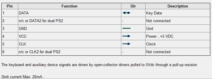

That is very odd. AFAIK, the PS2 connectors just have +5VDC on them and if you were to short them out, it would likely just shut down the PC. From: http://pinouts.ru/Inputs/KeyboardPC6_pinout.shtml
The PS2 connector would be getting power through the MB, not directly from the 5VDC rail. But from your description is does sound like the PS2 is involved somehow. I would check the PS2 connector on the MB. If it blew the PS, it should have melted the connector. You might open up the first PS and see what fried. Usually with smoke like that, it's the primary 110/220 VAC side of the PS, not the part that supplies low voltage. That side is usually fairly well protected, unless the ATX connectors themselves shorted out.
