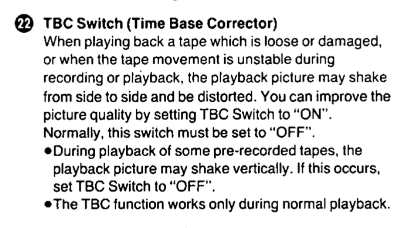

Second, according to the Panasonic data sheet, the TBC is "Full-field" (or field based) not frame based.
The manual has this for the AG-1980 TBC ...
The vertical jumping is an artifact of a field based TBC.
Also see...
https://www.videohelp.com/forum/archive/the-tbc-on-my-ag-1980p-is-making-my-videos-look...y-t373251.html
So shut it off and use an external full frame TBC.Recommends: Kiva.org - Loans that change lives.
