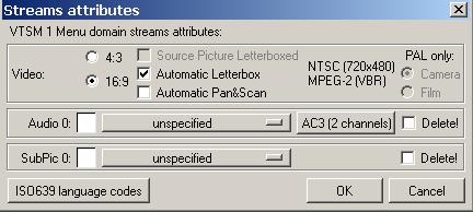

Most, if not all, disc authored by the studios are Pan/Scan designs. Meaning it shows wide screen on 16x9 and "center cut" on 4x3.
I remember you from a thread about GUIfordvdauthor. If you still want to use GFD, it allows 16:9 menus. I have done it. I used the "16:9 global aspect ration for menus" option, plus the "PanScan for 4:3 TV" option. (See Settings->Project->Menu.) Otherwise, the text can be too small when the menu is letter-boxed.

I think you can create 16:9 animated menus with PanScan for a 4:3 TV, but only when muxman is used as the authoring engine for GFD. The animation used could be a movie clip. I don't remember what the time-limit is for the clip, but the clip can be looped to play continuously.
I have only tried GFD for 16:9 still menus so far. I can try making a motion to prove GFD works for 16:9 motion menus too, but not until tomorrow evening. I am going to be busy doing something else tonight. -

Originally Posted by extentYou're not making any sense. Any authoring program that can create both 4:3 and 16:9 menus will make them so they look good on both 4:3 and 16:9 TV sets. Either you're not creating them properly (4:3 when they should be 16:9 or vice-versa, or they're improperly resized), or you don't have either the players and/or the TV sets set up properly. All properly created menus will play as they should on any kind of TV set. If you're creating a widescreen but 4:3 menu (why?), then you add black bars above and below so the ratio appears correct for both kinds of sets. If you're creating a 16:9 menu, then the player adds black bars for 4:3 display, unless it's set for Pan and Scan when played on a 4:3 TV set in which case it's cropped from the sides.many dvd menu creation programs only let me create dvd menus in 4:3, so

I was able to create 16:9 menus with animated backgrounds using GFD, with Muxman specified as the authoring engine. I used the PanScan for 4:3 TVs option on one menu. I used the Letterbox for 4:3 TVs option on another menu. In both cases the menu displayed as specified on a 4:3 TV.
[Edit] Video and audio in the clip I used had a duration of 1 minute and 37 seconds. I looped the animation so it would repeat as long as the menu was displayed. -
i noticed the 'add animations' option in Gui for DVDAuthor was always greyed out - is muxman the only way they work? im not sure how to set it up with muxman, i could not see anything in the Gui for DVDAuthor menu, unless i have to just install Muxman in the default or correct folder
Animated menu backgrounds are not created using "Add Animation". After you open a new project, use Settings->Project->General Setting->Animated Menus, then click OK. Next, right-click on the menu, and select "Menu Properties". That will allow you to select the video and audio files for the menu background.
