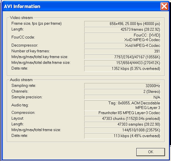

	This is the file information of my out-of-synch XviD according to VirtualDubMod.
 Can you tell what the problem is?

	The video and audio durations appear to match (within 0.02 secs). It would be interesting to know if the same applies to your original DV avi file.
 However, I suspect the problem might be that the XviD video has VBR (rather than CBR) MP3 audio, which often causes problems. How did you specify the audio conversion when you created the file in VDubMod?
