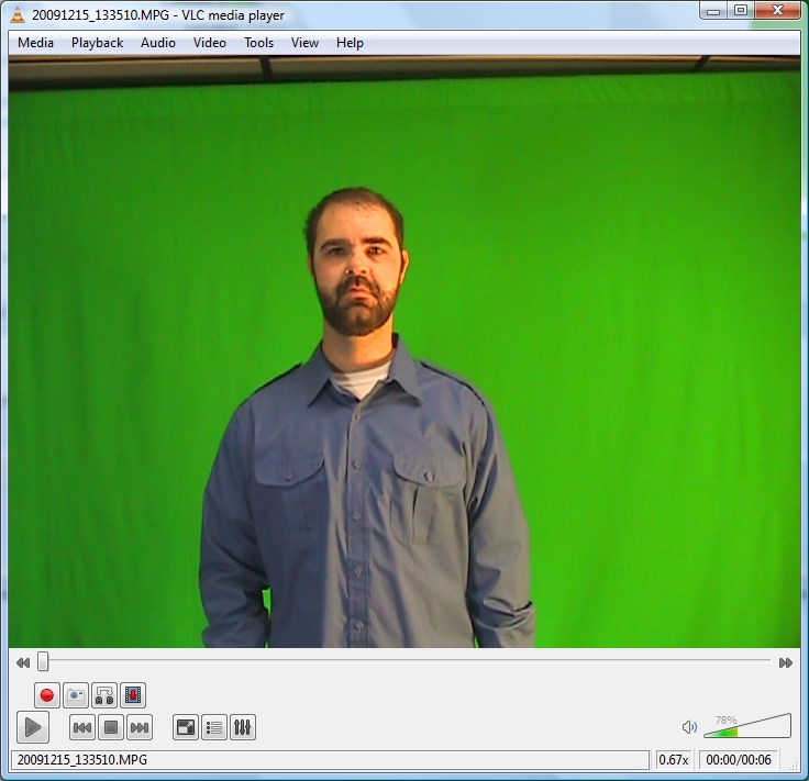

I'm really a complete newbie. I bought a Canon FS100, which uses .MOD files. From reading the internet, I found they can be renamed to .MPG for 4:3, and a program called SDcopy can be used to add correct "flag" info if they should be 16:9.
In Winamp, it looks stretched. In VLC, it looks okay. Both say it's 720x480, which I'm not sure how. I did find one article talking about square pixels and stuff, but it was beyond me. If that's the case, the pixels need to be less wide, or taller.

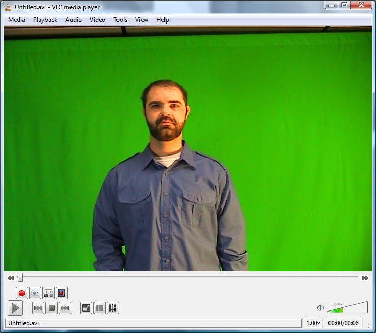

Attached is a still of the original video, looking as it should.

	I found an MPEG plugin for Virtualdub. It looks stretched (not tall enough or too wide) there as well, like my second image example illustrates.
