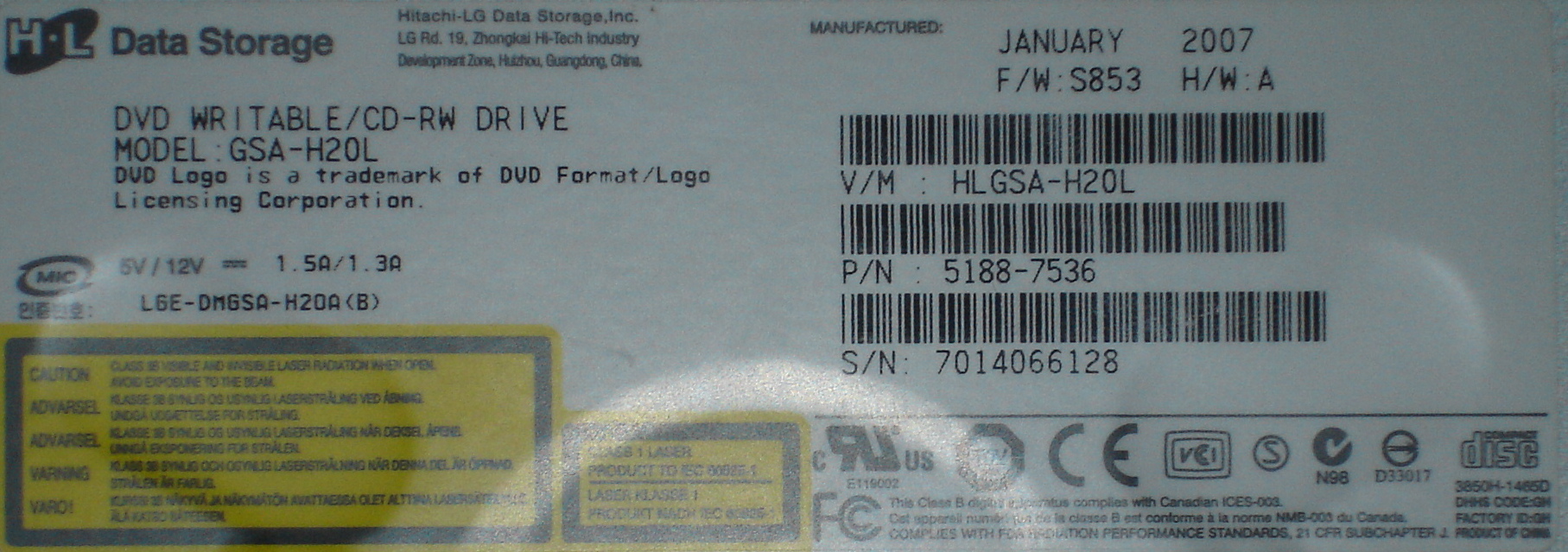

    I purchased the "GSA-H20L", NOT because watching unfinalized disks was important to me but rather because it was the only unit between the two descriped in the instructions that I could find. In any case, my unit is described as being a Hitachi/LG brand. It is stamped as being manufactured in January of 2007. The model is stated as being GSA-H20L.

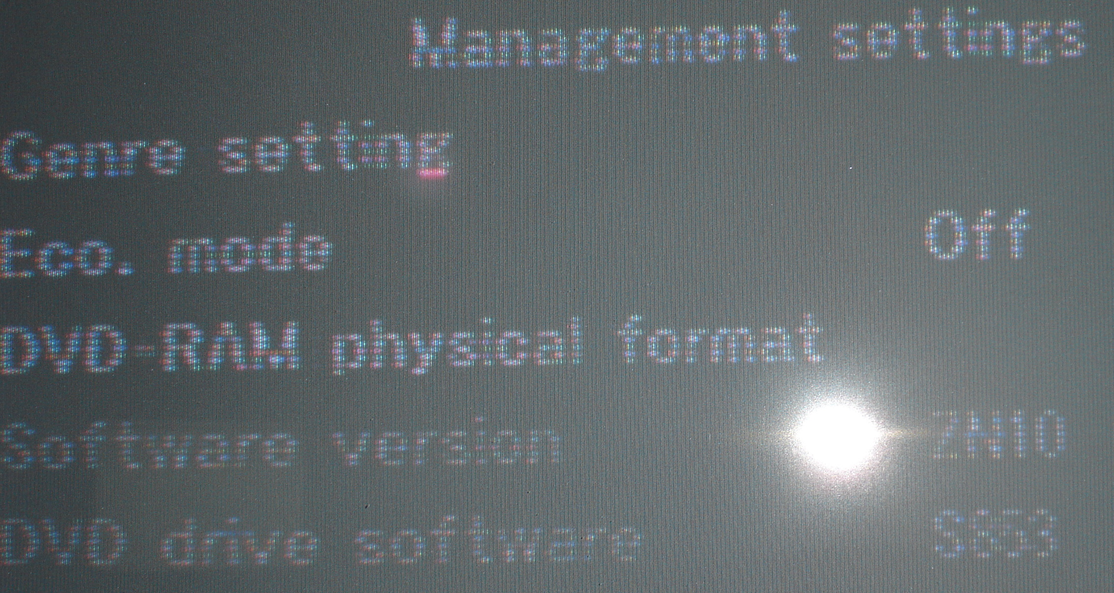

    On the burner of my GSA-H20L the firmware version is stamped as well. It is S853. I can go into setup on my DVD recorder and see this number as well so it's confirmed. The Toshiba firmware for my broken burner model SD-W3002 has two releases. These being DVD 1314 and DVD 1416. The one I was using was 1314.

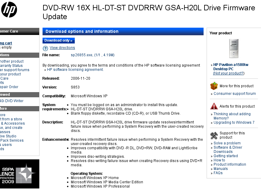

    I stumbled onto this website at url:
    http://h10025.www1.hp.com/ewfrf/wc/softwareDownloadIndex?softwareitem=pv-45140-1&lc=en...3198208&os=228
    As you can see from this site and the attached picture the "Version" is stated as being "S853". Additionally, the settings menu on my DVD recorder as displayed on the television also confirm this fact. Please refer to the attached picture. Finally, the label on my DVD burner also states this too. See pic.
    My question now is based on the evidence do these facts confirm WITHOUT DOUBT that this is a HP burner? AND THAT ANY FIRMWARE UPDATES NEED TO BE DOWNLOADED FROM THE HP WEBSITE AND NOT THE LG WEBSITE????????

    Dec 2009
    Here is the pic off of my television screen
    Dec 2009
    And this is the pic from my burner
