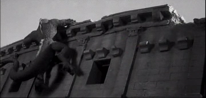

Hey, I just had a thought. In Vdub, I can save a .bmp of a given frame from both. Then could I attach them to this forum somehow? (I've never considered doing something like that on a forum.) Then you folks who probably have much better resources (including eyes) could assess this for me.

I see I CAN attach images! Nice that my test frame happened to be a key frame. This is the H263 one.
