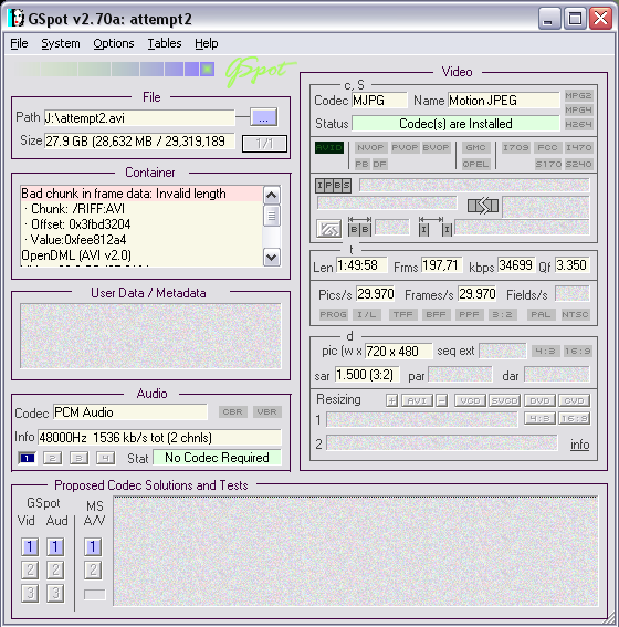

1 GB for every six minutes sounds like DV AVI. You can use GSpot or MediaInfo to determine the container and codecs.

You have anAVI file with MJPEG video and uncompressed PCM audio. At 30 GB it probably consists of 15 ODML chunks. But by the end of the first ODML junk the file is corrupt. That most likely occurred because the file undelete utility was not able to determine which unallocated parts of the disk were really parts of the original video file. So parts of the file you have did not come from that video. This is quite common when undeleting large files. I suspect the only way to recover more than first ODML chunk will be to do it by hand -- which requires someone who's quite familiar with how the internal structure of AVI files works, specialized toos, and at 30 GB, lots of patience. It's also possible that everything beyond the first ODML chunk is not even part of the original video file.
If the drive from which this video was undeleted is still available, and hasn't been used too much since the file was deleted, a different undelete program might be able to restore more of the video. -
