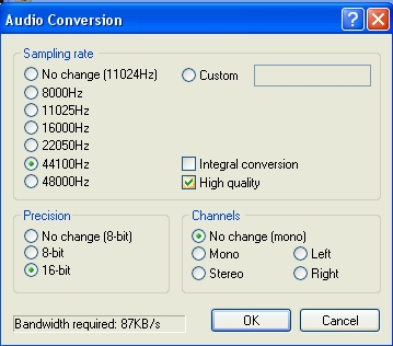

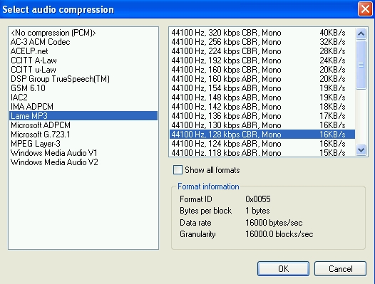

  7. VirtualDubMod:
    Streams -> Stream List
    right click on stream and select: Full Processing
    right click on stream and select: Conversion..., 44,100 Hz, 16 bit, high quality
    right click on stream and select: Compression..., Lame, 44,100 Hz, 160 kbps, CBR, mono
    vdubmod.avi

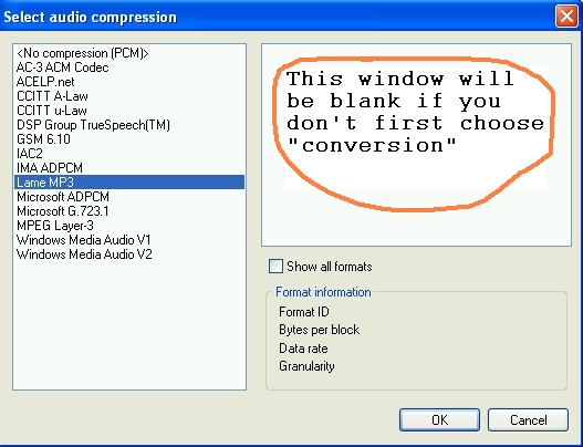

  8. PROBLEM SOLVED Thanks. I never have done that extra step (conversion) in VirtualDubMod. That did the trick. (See screenshot 1) When converting this particular file, if you don't first click "conversion", you end up with a blank mp3 parameter window (see screenshot 2). If you click "conversion" and set the conversion parameters, then you select "compression", "Lame" and then you can select the mp3 parameters (see screenshot 3).
  9. Lame doesn't like the 8 bit sample precision of the original. It will accept 22050 Hz though.
