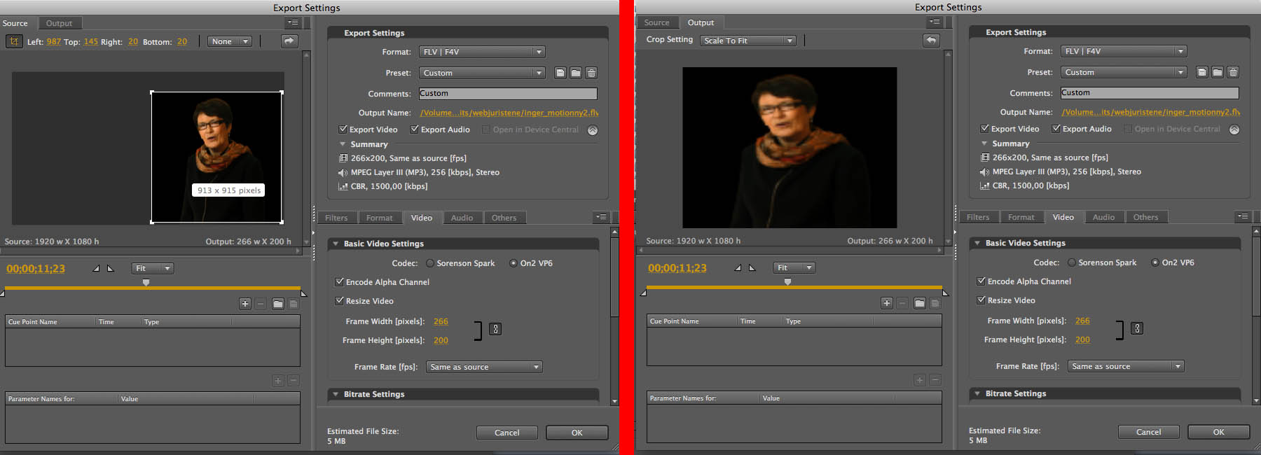

When i try to crop i cant get the right aspects AND size/output. Even if the aspect is right in the source pane the aspects in the output pane is wrong and when i choose "change output size" the possibillity for changing size in the low right cornoer greys out.

It's greyed out because you have "change output size" selected
There should be no change in AR. It should be 1:1 square pixel for a 1920x1080 source
Just crop to where you want to, leaving a 200x200 dimension. No need to resize.
If you insist on crop + resize, it has to be proportional. e.g. crop to 100x100 => resized to 200x200 (so you increase width and height doubled each). This is because the source consists of 1:1 pixels. If you don't do this the final image will be distorted from the original AR. (e.g. if you increase the height 3x, but the width 2x only)

I "insist" on resize because as yousee from the first screendump, the area i want to crop i 900x900 (aprx.) and i want the output to be 200x200. Thats why i choose "change output size". Maybe i shouldnt? The dimension on the .mov i have exported is 1920 × 1080 so its strange it changes the aspect when i want to export in 200x200 (does it every time i shift to outputpane and choose "change output size"
For me its very starnge that even is i have cropped proportionally the output size look to me that it changes the aspect, since my cropped ared i 900x900 and below this its printed that the output size will be around 1200x900.. strange... im a little newbie in this...

Ok, sorry now I see what you're doing and I see the problem.

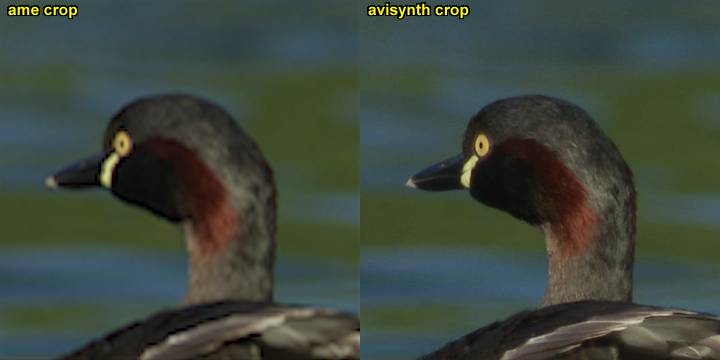

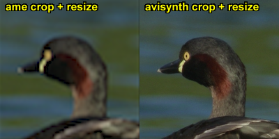

In AME, "change output size" definitely greys out the resize. Try "scale to fit" then 200x200 in the resize video option. If your original remaining crop box was same dimensions (width=height), the aspect ratio should come out right. I'm not a fan of AME's resizing because it uses a very soft (probably bilinear) algorithm
I would personally do everything in after effects. Easier to do everything from crop , resize ,keying. I have the primate keyer for AE. I find keylight better for most sources. If you want better scaling and algorithms, you could do part of the manipulation in avisynth (but hard to access on MAC)
