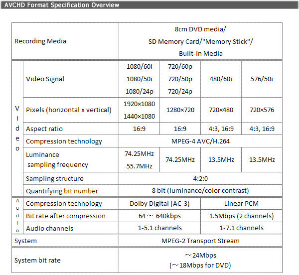

    You don't have to upscale. 720x576 / 50i is a legit AVCHD and blu-ray spec. I haven't done a PAL version, but I've done an SD version with similar content playable on a NTSC blu-ray player before.

    Thanks for that. I took a look at support for AVC in vegas last night and it doesn't allow me to save a video stream as 720x576/50i. What software could I use to make compliant 720x576/50i. I'm just experimenting at the moment, but think that with the superb compression that avc should provide that I should be able to get more than an hour on a DVD at a decent bitrate.
