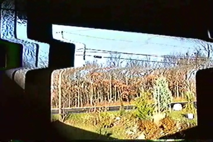

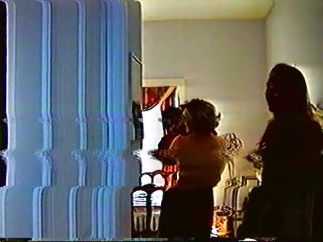

Hello Jagabo
Here are two examples, I've been at this for 5 days trying everything, I'm burning out. Help!
Thanks Stewart
You need a timebase corrector AND/OR a better camera.
I work on tapes like this all the time.Want my help? Ask here! (not via PM!)
Hello Thanks for the input jagabo and lordsmurf.
Lordsmurf and all, I did borrow my brothers camera (doesn't have stereo sound however) and the capture is working much better, the recordings made are very acceptable. However, is there an answer as to why my TR-77 vtr will play flawlessly through a tv but not through the capture?
Stewart -
Time base errors are one of the methods used in copy protection (Macrovision) of commercial VHS tapes. TVs just ignore these errors but many recording devices are intentionally made sensitive to them -- to keep you from copying the tapes. Unfortunately, time base errors from poor recordings or old tapes can look like copy protection to some devices so they stop recording or give you screwed up images.
