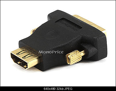

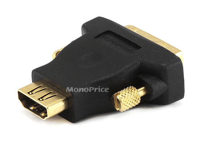

  29. Member edDV's Avatar
    Mar 2004
    Northern California, USA
    Yes you could try a HDMI to DVI-D cable or adapter.
    http://www.monoprice.com/products/product.asp?c_id=104&cp_id=10419&cs_id=1041902&p_id=...seq=1&format=2
    On my Samsumg 1920x1080 2333HD monitor, "Just Scan" works to provide 1:1 pixel mapping and clear text.
