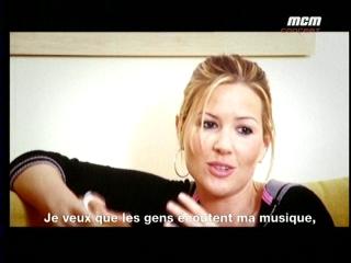

    Hey, a while ago I came across an effect applied to a webcam stream through Flash, then it wasn't where it used to be anymore and just a few hours ago I found someone who knows how to create the effect in Flash
    http://www.adobe.com/devnet/flash/articles/webcam_motion.html
    Here's the zip with the swf and fla files:
    http://download.macromedia.com/pub/developer/webcam_old_new.zip
    webcam.swf is the one I'm interested in.
    But there are many inconveniences with flash, such as small size(the bigger the laggier it will get), the slow framerate and having to record it and cut out the needed area of the screen.
    So I was wondering, is there any software out there that has a similar effect for videos? Or anything similar at all?
    Would be greatly appreciated.

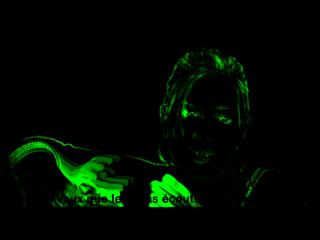

  2. It can be done with AviSynth filters. Something like this:
    src=AVISource("small.avi")
    diff=Overlay(Trim(src,1,0), src, mode="Difference").ColorYUV(off_y=-128).ColorYUV(gain_y=256)
    f0=diff.ColorYUV(off_y=-200)
    f1=Trim(diff,1,0).ColorYUV(off_y=-150)
    f2=Trim(diff,2,0).ColorYUV(off_y=-100)
    f3=Trim(diff,3,0).ColorYUV(off_y=-50)
    f4=Trim(diff,4,0)
    acc=Overlay(f0, f1, mode="add")
    acc=Overlay(acc, f2, mode="add")
    acc=Overlay(acc, f3, mode="add")
    acc=Overlay(acc, f4, mode="add")
    return(ConvertToRGB(acc)).RgbAdjust(r=-255, b=-255)
    The critical function here is the first Overlay(Trim(src,1,0), src, mode="Difference"). That subtracts one frame from the next resulting in only differences between frames. The rest of the script is there to approximate the green image and trails.

    Oh wow, words cannot express my gratitude, thank you so much!
    Gonna go try that.
