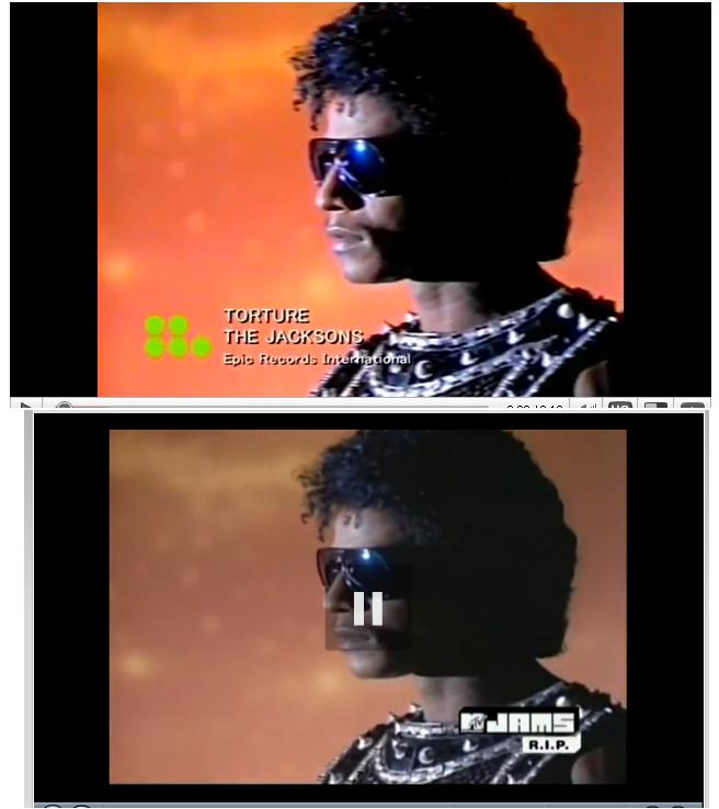

As requested, here are some examples about the type of work I am talking about:
For the easy task, namely removing a temporary solid logo within a solid background, please watch this music video clip by Paul McCartney:
http://www.dailymotion.com/video/x22vz3_paul-mccartney-coming-up_music
For the more complicated task, namely replacing a logo section of a music video X with the same section but logo free coming from the same music video X sourced from a different supplier, please watch this music video by The Jacksons from two different channels:
http://www.youtube.com/watch?v=dtzD8E51Zjk
http://vidds.net/v/en/jacksons-torture_d4d3i324q3m3j364o4z2x2.html
As you can see, the logo on both of these versions of the same music video by The Jacksons is placed on different locations on each video, so the idea is to eliminate the logo section on the first video by pasting the same section but logo free coming from the second video.
