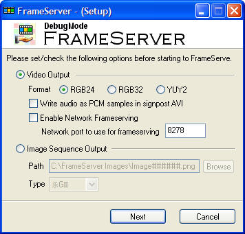

Update: Is a dialog supposed to appear? I've seen some old screenshots of FrameServer where a dialog shows up asking for format, but I'm not seeing any dialog, just the standard Vegas rendering thing I get with any other render as option...

You use file=>render as , select save as type "debugmode frameserver", and this dialog should pop up:

The drop down menu should have a separate entry for debugmode frameserver, and as soon as you push save, the dialog box should pop up. Once you push next, nothing should be rendered, just the dummy AVI. The rendering actually occurs when you frameserve the dummy AVI with avisynth.

Okay. Reinstalled everything to default directories, and now the save as FrameServer type shows up, but when I press save, instead of a dialog popping up, Vegas shut down quite abruptly. Any more ideas? You've certainly gotten me further than I was. xD I'm gonna try restarting my computer. Seems too simple to work though. xD I'll update here if it does.
