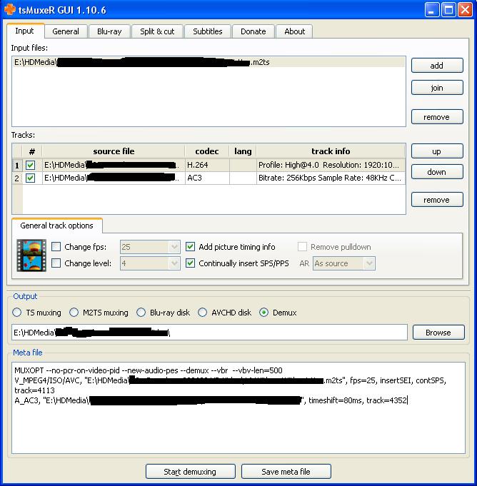

I have a bunch of .m2ts files that have AVCHD video shot from a Canon HF20 (I think). By all accounts, the video is 1920x1080 @ 25fps, with AC3 audio. The audio and video are perfectly fine in the individual source .m2ts files, but I need them joined together inside a single MKV (and oh, by the by, mkvmerge doesn't support M2TS -- arrggh). During the tsmuxer join, I can see:
SmartLabs tsMuxeR. Version 1.10.6 http://www.smlabs.net
Decoding H264 stream (track 1): Profile: High@4.0 Resolution: 1920:1080i Frame rate: 25
H.264 stream does not contain fps field. Muxing fps=25
B-pyramid level 2 detected. Shift DTS to 3 frames
Decoding AC3 stream (track 2): Bitrate: 256Kbps Sample Rate: 48KHz Channels: 2
...and success. The resulting joined .m2ts file (joined.m2ts) ends up being roughly the same size as the combined individual files, and the audio and video are synced just fine. So now I need an h.264 and an audio stream to shove into an MKV (remember, mkvmerge doesn't like .m2ts files), so back to tsMuxeR to break up the joined .m2ts file, using these options:
MUXOPT --no-pcr-on-video-pid --new-audio-pes --demux --vbr --vbv-len=500
V_MPEG4/ISO/AVC, "joined.m2ts", fps=25, insertSEI, contSPS, track=4113
A_AC3, "joined.m2ts", timeshift=160ms, track=4352

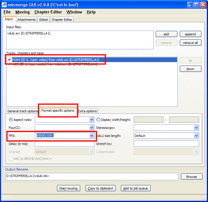

	Set it to what? The GUI only lets you choose from the drop-downs, and you get 24, 25, 30, or 23.9xxx and 29.997-ish. And I don't see a tab called "Format Specific Options." Do you mean the "General track options" right below -- where the fps drop-down is? The one that won't let me enter another value?
 I tried using the CLI version with a .meta file using
 V_MPEG4/ISO/AVC, "filename.m2ts", fps=50, insertSEI, contSPS, track=4113
 A_AC3, "filename.m2ts", timeshift=160ms, track=4352
 It didn't seem to make any difference... like tsMuxeR ignores any fps value not in its legal drop-down list already.
	Well color me a (ignorant) turd.... at 3am, I didn't pick up that mmg.exe was the GUI. @#(*&@ing A. So it's absorbing the .264 and the .ac3 into a new MKV now at 50fps. Let's see what that does....
 Status: Mission Accomplished! I now have an 85 min 1080i video with perfect audio sync.... Sweet.
 Whose PayPal account am I sending the bill payment to? I don't recall seeing any mention of a freakin' GUI for mkvmerge in any of the author's docs, but it was 4am, and I haven't slept since.
 Thanks a ton, guys!!
 I am curious, though -- what is the command-line equivalent of setting that fps option in the GUI? I know I'll end up needing it again somewhere down the line.
	Well, crap. Looks like "--default-duration 0:50fps" would have done the trick all the way around. I was using a time-based entry of "--default-duration 0:5100s" (85min), which I thought would accomplish the same objective.
 I'm testing that on some of the original smaller/unjoined files, and it seems to work. The acid test, though, is that my WDTV Live media player can play the merged 9GB MKV file just fine, which was the end goal. Thanks, guys! You rock!!
