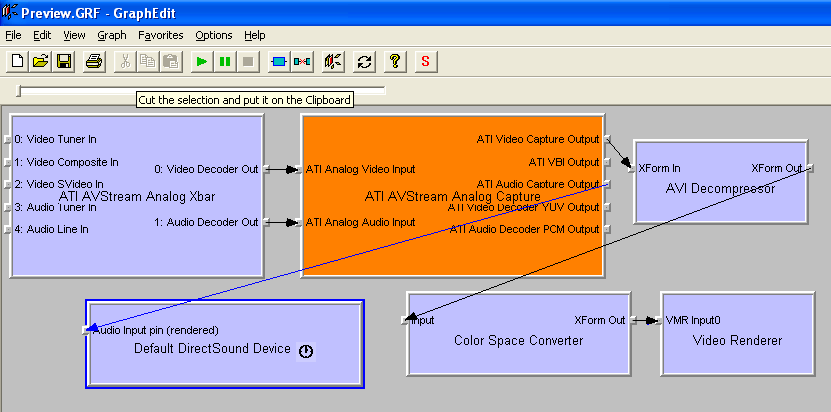

You can check your card using Graphedit.
Insert ATi AVStream Analog Xbar, ATI Analog Stream Capture and from DirectShow filters Video Renderer. Connect first two (see picture) and the last Video Renderer at ATI Video Capture Output. From Xbar click right and select composite or S-Video and from ATI Analog Stream Capture >> Video decoder NTSC standard. Before hit play connect a video source at composite or S-Video input.
