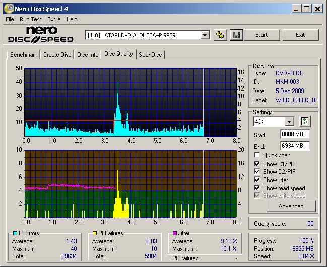

    Received my discs from Newegg and tested them. The 16x Verbatim DVD-R single layer are excellent quality. However the 8x Verbatim DL DVD+R aren't good quality, not like any I've ordered before. These have high broad PIF bands on the 2nd layer, and quality scores around 50%. I've asked Newegg to accept their return for a refund, but haven't heard back yet.
    Which all goes to prove that Verbatim is no longer a reliable brand. It's like shooting craps. I may give up disc backups entirely and switch to portable external drives. I believe Staples had a 1TB external USB drive recently for something like $69 US. That's cheaper than discs and less hassel. If I do so, then I'll have to give up my standalone DVD players too and switch to an entirely computer-controlled video system. Maybe that's just as well.

    These have high broad PIF bands on the 2nd layer, and quality scores around 50%. .........goes to prove that Verbatim is no longer a reliable brand.
    Sorry, but that's just not proof of anything. Your testing methodology is flawed.
    I disagree. There's nothing wrong with my methodology or testing with DiscSpeed, although I'm aware of your prejudice against. You frequently make such anti-DiscSpeed claims but without documentation in support. My quality scans are good evidence that buying DL Verbatims is like shooting craps. You never know what you'll get because they have no quality control.
    As has been proven over and over again, these tests are often more a statement about the drive or environment, rather than the disc itself.
