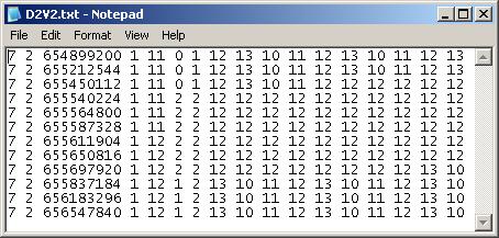

    If I look through the .d2v files, will those cadence breaks when it changes from x0 x1 x2 x3 ... to something more like x2 x2 x2 x2 or something like that? Theoritically, I should be able to go to those scene and see what is happening, right?
    Also, when you say there is a cadence break, is it just one frame that will be messed up (or group if there are multiple together)? Or does it propogate throughout further frames?
    Yeah, you can go and look for those places. Kind of a pain in the ass, though, when they're in the middle of the film.
    If chapter breaks, you'll get 2 interlaced frames. Criterion is notorious for this because they (or their DVD production house) force chapter points during the encode, rather than when authoring. And it breaks the cadence. Otherwise, it can be any number of frames, and seemingly for no reason at all. Here's one I saved out 3 years ago before Donald Graft (neuron2) began to update the original DVD2AVI to become DGIndex:
    It's going along at x0 x1 x2 x3 x0 x1 x2 x3, when all of a sudden you get this long string of 2s. Right in the middle of the movie. And for no good reason. It's no problem if watching on an interlaced CRT television, but it can wreak havoc on a progressive scan player outputting to a progressive display, depending on how good the player is and how quickly it spots the change.
