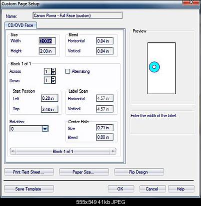

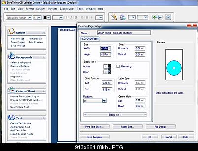

    if you have surething cd/dvd label software you can adjust the size and starting position of the label.

    after changing to the reduced printing area you will have to experiment with the starting position to get it centered.
