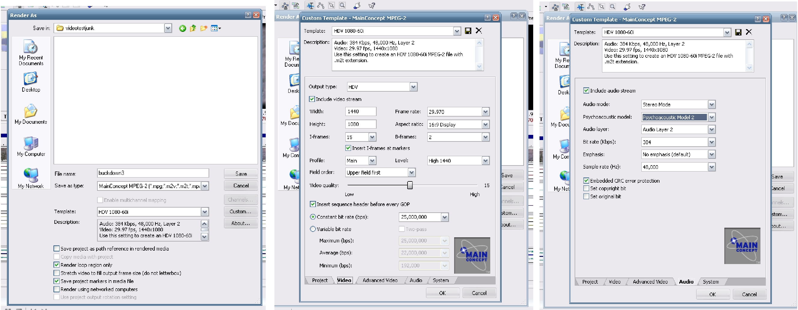

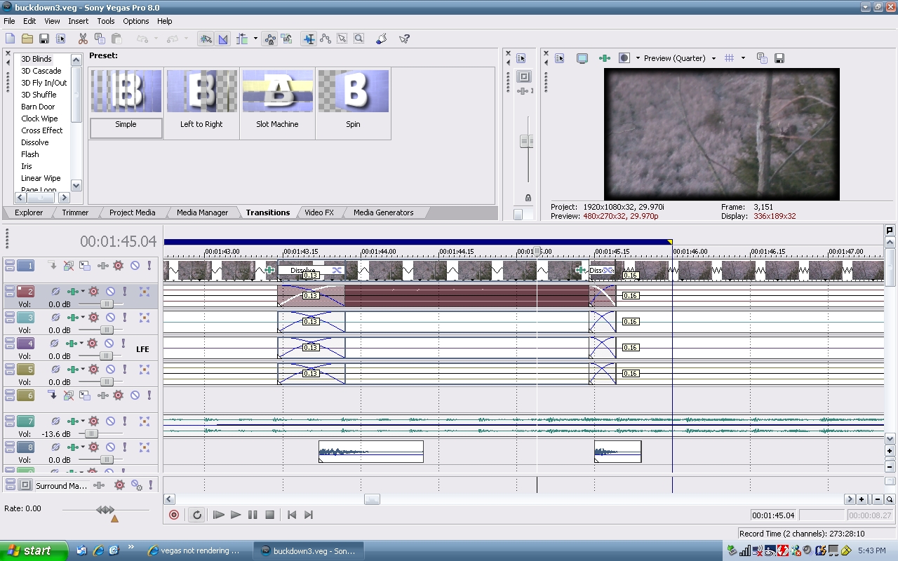

    Post a screenshot of your timelines and your render settings
    Read my blog here.
    Nov 2009
    these render settings are pretty much standard for this template. I have tried quite a few variations.
    Nov 2009
    timeline
