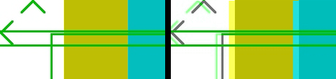

The feature of Flaxen VHS that you'll want to use is the Chroma Shifting. You'll probably want to shift I and Q left (negative values) by a few pixels. This doesn't increase the sharpness of the chroma channels, but shifts them sideways. You can also shift vertically but I've rarely seen a need for that, maybe up by one line on occasion. Low pass filters cause the chroma channels to slide to the right, hence the need to shift them to the left.
Here's an example. On the left is the normal image, on the right the chroma channels are shifted left by 8 pixels:
VHS won't be this sharp of course, but the effect is obvious here.

Shifting the chroma channels will not cause any ringing. Sharpening them will.
Note that this does not eliminate color bleed due to do low pass filtering. What it does is keep the bleed from being all on one side. By centering the bleed it becomes less obvious. -
It often just creates colored halos. Halo = ringing
No, sharpening causes halos. VHS's chroma shift simply shifts the chroma. If there are halos afterwards it's because there were halos before. Where are the halos in the sample I posted?

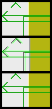

Actually, Smurf may be right about Flaxen's VHS filter. It has some kind of bug where what it does isn't completely reversible. Ie, starting with a clean image, if you use it once to shift the chroma one way, then use it again to shift it another way, the luma channel is effected -- you can see a ghostly shadow of the shifted chroma. (Obviously, all VirtualDub filters receive RGB but filters like this that work in YIQ or YUV do their own internal conversions.)
The OP may find that AviSynth's ChromaShift() works better. I have verified that it doesn't screw up the luma channel and it is completely reversible. Crops from a larger frame:
The top is the source image. The middle is the source after ChromaShift(c=6). The bottom is the source after ChromaShift(C=6).ChromaShift(C=-6).
The same source with I and Q shifted right by 6 then left by 6 with Flaxen VHS. Note the "shadow" defect:
Also remember that the bleeding may not be caused by a simple shift in the chroma. Complex/compound errors aren't correctable -- and I see those far more than simple ones.
