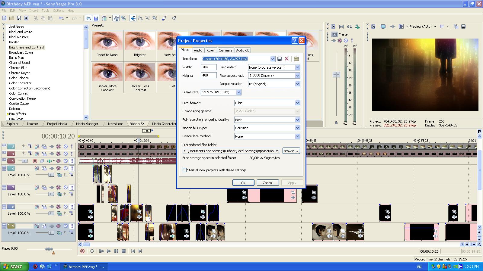

    I've attempted to do what jagabo said and set my project template to widescreen and just overide the AR of the source video, while it fixes the problem inside vegas, (The footage normally appears to be widescreen when previewed in the inbuilt DRAM preview) though regardless of how I render it out, and to what PAR it set it to it's still not a widescreen video when I export it, even after changing the render settings to make the PAR 1.2121 (To match the NTSC WS template)
    What PAR is widescreen footage, because honestly the '1.2121' just confuses me

  5. Your screenshot shows the PAR set at 1.0 (square), not widescreen.
    DAR = PAR * SAR
    DAR = 1.2121 * 704:480
    DAR = 1.2121 * 704/480
    DAR = 1.2121 * 1.467
    DAR = 1.778 ==> 16:9 widescreen
