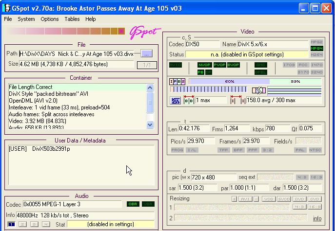

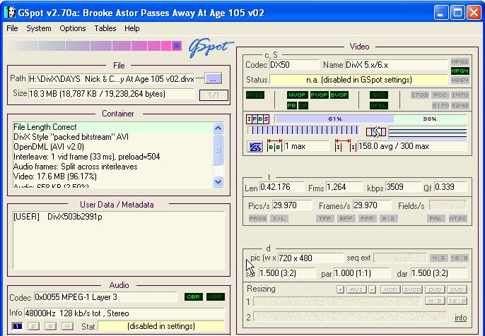

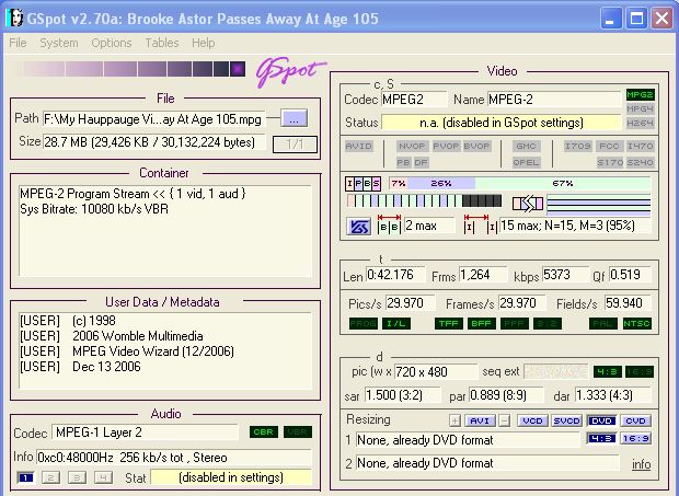

  3. deadrats: Thanks for your input. Here are some screenshots for additional information on this topic:
  4. Here is another screenshot:
  5. GSpot Specs for Original Mpeg2 File:

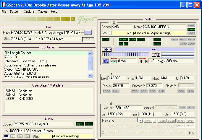

  6. GSpot Specs Screenshot for conversion to an .xvid file by AviDemux:

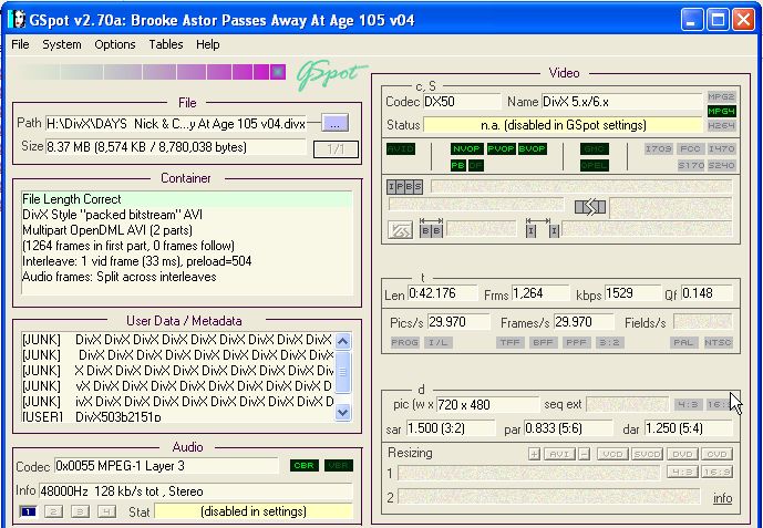

  7. GSpot Screenshot of Tmpgenc Xpress 4 with Resize (Fullscreen Option):
  8. GSpot Screenshot of Specs for Tmpgenc Xpress Post (Full Screen without margin) option:

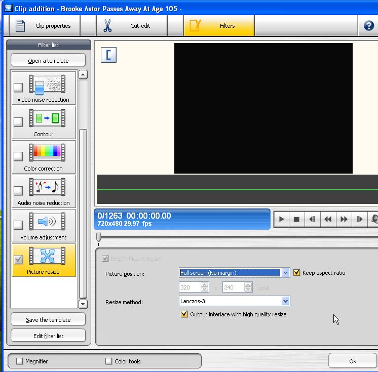

  10. A look at the Tmpgenc Xpress 4 Resize Filter Screen: This option cannot be turned off.

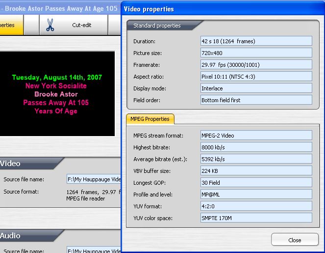

  11. A look at the video properties of the original mpeg2 file before it is converted by Tmpgenc Xpress 4:

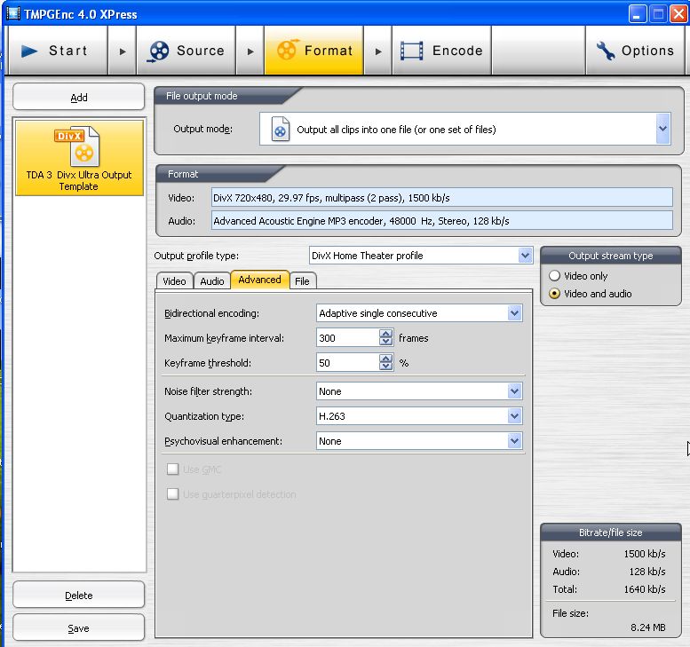

    A look at the Output Screen in Tmpgenc Xpress 4:

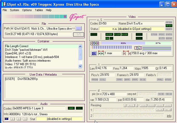

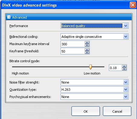

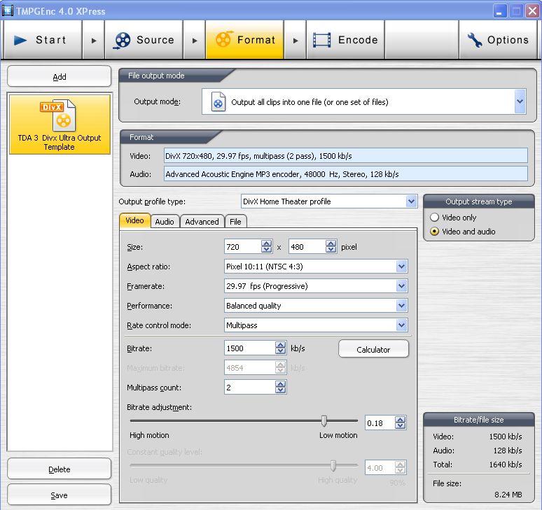

  14. I think I have come across the solution. First in the resize filter select full screen and proceed on to the next step in the program. Instead of using "Basic Mode" choose advanced mode. If you change the pixel ration from 1:1 to pixel 10:11 (NTSC 4:3) you end up with a file very close to your original video size aspects of your original mpeg2 file, with the exception that it is now a .divx file. The resulting file is excepted by VLC and my Phillips Divx Ultra Player. I made a template in Tmpgenc Xpress 4 to reflect the setting in TDA 3.0 when it makes a Divx Ultra File. I am going to post some screenshots from GSpot and just about every spec matches up between the Divx Ultra file produced by TDA 3 and the Divx Ultra-like file produced by Tmpgenc Xpress 4. I am also posting some screenshots of the video settings pages in TDA 3 for the Divx Utra Specs and the video settings pages in Tmpgenc Xpress Advanced Mode. I tried to match the setting wherever possible.
    TDA 3.0 Divx Ultra Video Setting 01
    TDA 3.0 Video Setting 02
    Tmpgenc Express 4 Divx Ultra-Like Specs 01
    Tmpgenc Xpress 4 Divx Ultra-like Settings 02
  15. Finally done; I got a tad obsessed at trying to figure this out. I got to go to the Doctor, I have developed a condition where "heavy duty thinking" results in my butt getting hot. Forgive me for me throwing in some self-deprecating humour in here. I will post a link to the "Divx Ultra-like file" once I upload it to MediaFire. I will probably delete the files on Monday, since this topic is about rapped up. I put the various files on a usb stick and watched them on our television. The .xvid file was hard on the eyes at times, it was very noticable on the television. Maybe that is something that can be figured out someday. I hope that the information has been useful to atleast one person. Maybe deadrats will find it useful.
    the "output screen" shows what the problem is: notice that you are choosing square pixels (1:1) with a resolution of 720x480, what you should do is change the (1:1) so that it shows (4:3), alternatively leave the pixel ratio as it is and change the resolution to 640x480, either one will produce the correct output, though as i said i prefer to keep everything as it was in the source, which in this case means 720x480 4:3.

  18. deadrats: The problem was with the basic mode it didn't allow me to change the pixel ratio. I was hesitant to go to advanced mode because there was a warning that it may not play on a .divx player. Thankfully my .divx ultra player has a usb slot so I just transferred these files to a thumb drive and then tested them out. I used the .divx ultra specs in TDA 3.0 as my guide. My original video source is interlaced but TDA 3.0 always chose "Progressive" as the display mode, and since I have always been pleased with the .divx ultra files, I chose that setting in Tmpgenc Xpress 4. I don't know if it converts "interlaced" to progressive or not. In the filters section of Tmpgenc Xpress 4, I chose "de-interlace when necessary" and I don't know if that helps or hurts the resulting files. I converted a bunch of small files the other day with the batch mode and the program plugged dilegently away at them, but I saved my original mpeg2 files, until I watch some of these files on my tv and see if I am satisfied with them. I made a specific .divx ultra-like template and apply that to all my mpeg2 files. Now it is just a matter of seeing if I am content with the resulting .divx files and then I can delete my original mpeg2 files.
