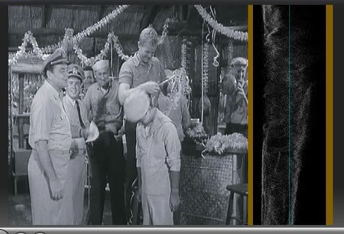

    I have a strange purple color appearing in a black and white encode
    import("C:\Program Files (x86)\Winnydows\XviD4PSP5\dlls\AviSynth\functions\AudioFunctions.avs")
    import("C:\Program Files (x86)\Winnydows\XviD4PSP5\dlls\AviSynth\functions\ VideoFunctions.avs")
    loadplugin("C:\Program Files (x86)\Winnydows\XviD4PSP5\apps\DGMPGDec\DGDecode.dll")
    loadplugin("C:\Program Files (x86)\Winnydows\XviD4PSP5\dlls\AviSynth\plugins\ba ss\bassAudio.dll")
    loadplugin("C:\Program Files (x86)\Winnydows\XviD4PSP5\dlls\AviSynth\plugins\TI VTC.dll")
    video = MPEG2Source("D:\mchals navy\202\202.d2v",cpu=0,info=3)
    audio = bassAudioSource("D:\mchals navy\202\202 T80 2_0ch 192Kbps DELAY 0ms.mp3")
    AudioDub(video, audio)
    AutoYV12()
    TFM(order=1).TDecimate(hybrid=1)
    #plugin_files
    LoadVirtualDubPlugin("C:\Program Files (x86)\Winnydows\XviD4PSP5\dlls\AviSynth\plugins\MS UDenoiser.vdf", "Denoiser", 0)
    ConvertToRGB32()
    Denoiser (50, "20.0")
    ConvertToYV12()
    Crop(6, 0, -10, -0)
    Lanczos4Resize(640, 480)
    Is there a option I could use to have it not do that?
  2. Member craigarta's Avatar
    Jun 2001
    Cascade Mountains
    Should that be in place of the AutoYV12()?
  3. AutoYV12() simply converts to YV12 if the video isn't already YV12. Mpeg2Source() is probably delivering YV12 so you probably don't need AutoYV12().
    Unless those color splotches are in your source the only filter I see that might be causing them is MSU Denoiser.
    If you put Grayscale() at the end of the script you'll guaranty that the output from AviSynth will be grayscale. But you can put it anywhere after the splotches show up.

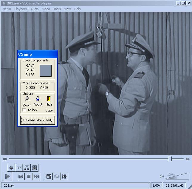

  9. Originally Posted by themaster1
    with paintshop (or photoshop):
    That's nowhere near gray. There's something wrong with your monitor -- or your eyes.

    Not with his photo but the 1st one there is
    whoops!! I looked at the photo with a different monitor and it went bye bye.
    I was thinking maybe it was mee for a second there

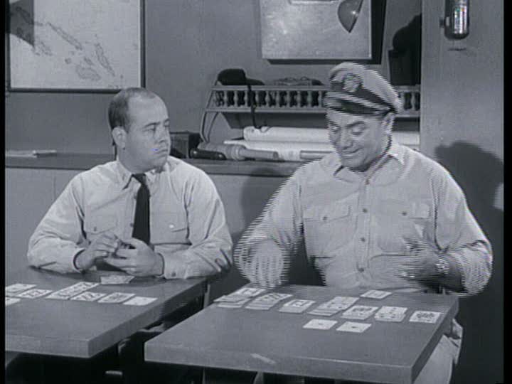

  14. Original image, trimmed, plus:
    GreyScale()
    Levels(40,1,200,0,255)
    You need to adjust the Levels() parameters based on a larger sample of the video. But I think this is much closer to correct.

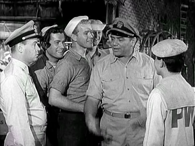

  15. Member craigarta's Avatar
    Jun 2001
    Cascade Mountains
    OK I played with it a bit and this what I got

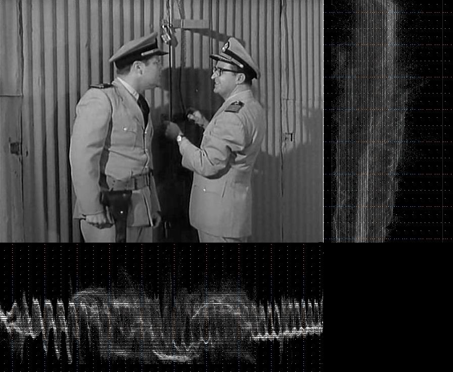

  23. It's nice and gray now. I did see (with an RGB tool) a few pixels here and there that weren't perfectly gray. You have a bit too much contrast now but you're getting the idea.
    By the way are you sharpening the video or are those oversharpening artifacts in the source? All the sharp edges have halos.

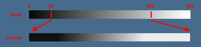

  27. http://avisynth.org/mediawiki/Levels
    Basically, Levels(40,1,200, 0,255) says to stretch the brightness from the range 40-200 in the input video (source), to 0 to 255 in the output video. Darker shades get darker, brighter shades get brighter. Shades darker than 40 are all converted to 0, shades brighter than 200 all get converted to 255, and the middle 160 shades get spread out. The gamma argument (1) says to use a linear stretch.
