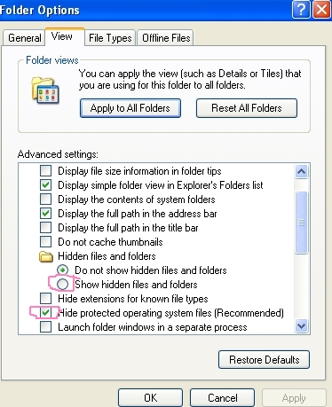

  1. I think a computer has a virus. It won't allow me to change the parameters to show hidden/system files. (See screenshot, purple circles). If I try to change the parameters and click Apply, the parameters won't change. So I cannot see hidden/system files. I am guessing a virus caused this. My question is: Is there any way to solve this problem (change parameters so that I can see hidden/system files). Of course I can go to the DOS prompt and remove the hidden/system attributes of a file (attrib -h -s filename.exe), and then I can see the file, but I want to be able to see hidden/system files all the time.

    Go to your control panel, then in there you will find user accounts (click on that), then you will see your account and the guest account and if your admin. it should say computer administrator under your name.

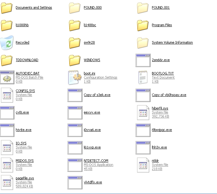

  18. I checked Installed Programs, Program Files, couldn't find anything suspicious. Then I booted into Safe Mode and deleted about 60 hidden viruses from the root C,D, E drive. ( I could see the hidden files after using the above vbs script.) However, when I reboot, hidden files are again set to be hidden (until I use the script.) So far, after about an hour of using the computer, no viruses have obviously returned. I tried to install the free AVG, but when I clicked to install, I was immediately taken to their website. This seems to indicate the AVG won't install on that version of Xp. My question is: What other free anti-virus can I try? I know that AVG setup file is valid, because on another Xp computer, I can start the install process.

  23. PROBLEM SOLVED. I was able to install Avast Free. It scanned during the Windows Xp blue screen bootup and found 604 viruses and put them in the chest. Then I scanned once more from the Avast Windows interface (skin looks like a DVD software player) and it found one more virus. Now the computer shows hidden files, even after bootup. Thanks for your help. In the past, I thought that such a deep virus infestation could only be solved by a reinstall or Ghosting from a backup CD. I did notice that during the virus scan, viruses were found in the Ghost backup file, in the System Restore file and in the System Volume Information folder. I think Avast Free is going to put the virus makers out of business.
