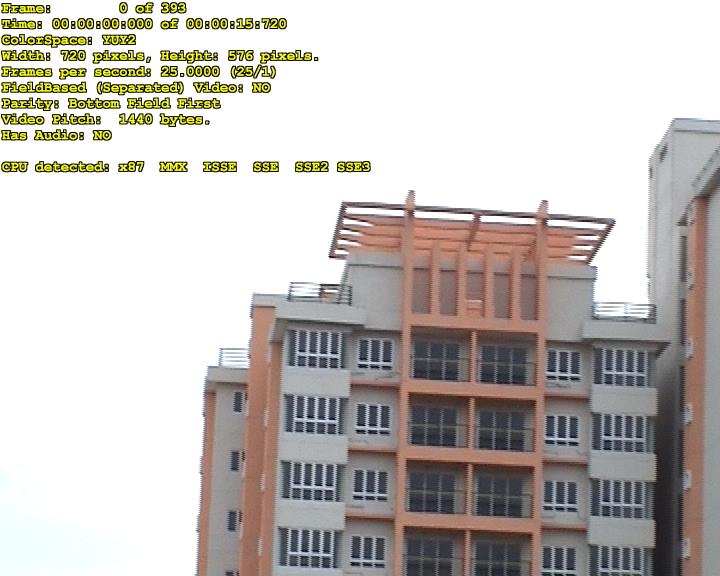

It looks like everything is set up correctly. I can't duplicate your problem here. Are you sure there isn't something wrong with that particular file? Try this DV AVI file:
http://rapidshare.com/files/308803949/PalDv.avi.html
Also try using VirtualDub instead of VirtualDubMod. Aside from being more up to date, it has a built in DV decoder that you can enable. -
