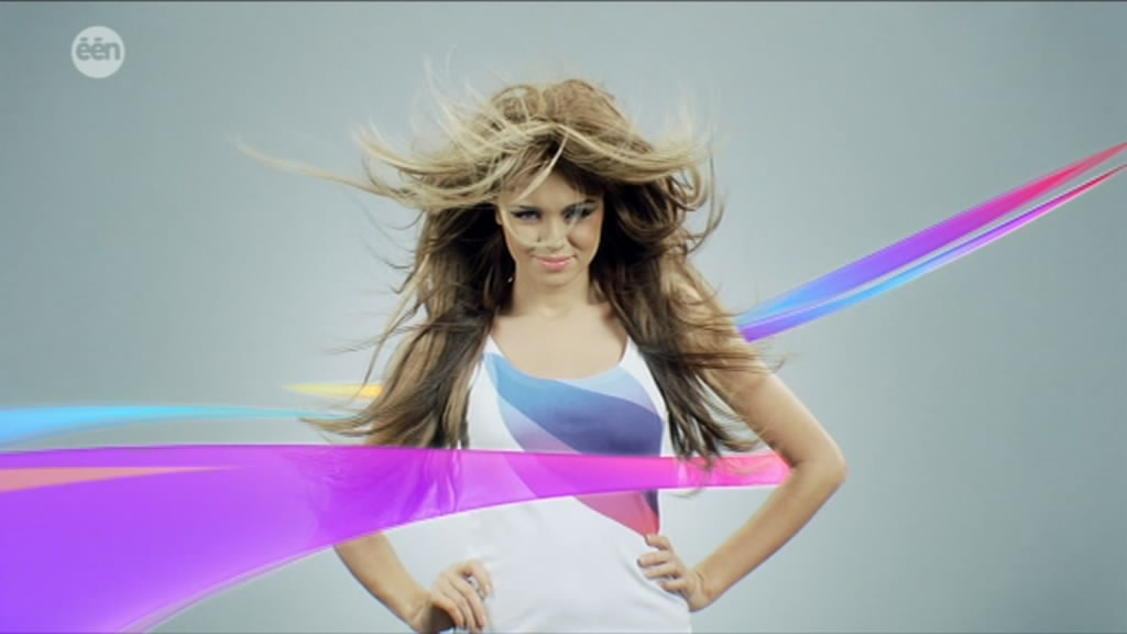

    Example : from previous Eurovision Song Contest I captured video from één HD on cable (1080i) and satellite (720p).
    I took 2 screenshots from the exact same frame, then I resized the satellite screenshot to match the 1920x1080 I obtained from cable, and then took the right half of the satellite version and copied it onto the cable version to create the first image :
    I then did the same thing with the SD versions (576i in both cases to create this merged picture) :
