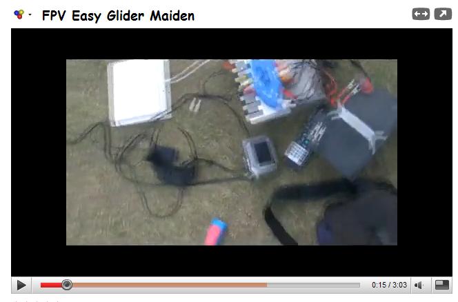

I have Pinnacle Studio 12 (Getting 14, I hope one day). I record video in two different ways. Most is recorded on a HDD Digital recorder, which records to a hard disk, at 640*480 (I think) MPEG2. This records my FPV videos. FPV is where you have a video camera (small spy style one) on a remoet controlled plane, transmitting the video down to my ground station, and I fly the plane using goggles.
Here's an example:
http://www.youtube.com/watch?v=rmUGqRW_BQ8
The second method is using my JVC Evario HDD based HD video camera. It records in a .TOD format. My research on the camera was poor, and if I'd known it wasn't a mainstream format, I'd never have got the camera 18 months back - but I did. Pinnacle does seem to support .TOD files though, so it's not too bad.
Here's an example from that camera.
http://www.youtube.com/watch?v=ffAeUH-epyk
Both are horribly interlaced. In Pinnacle, I selected the 'De-Interlace (Odd field, Bilinear)' option, but that didn't have much effect. Also, it crashes when it tries to apply the effect to my .TOD files. Doesn't crash on the MPEG2 files, but also didn't make a difference.
Could anyone suggest a method for me to achieve higher quality video? I am not a company, or a pro, or a profit maker... so, the cheaper, the better. A 'batch convert' for the .TOD to MPEG2 would maybe be a start?

Looks like blend deinterlaced to me (or just a big resize without paying attention to interlacing):Originally Posted by lordsmurf
Your footage is so shaky it's really hard to tell.
Thanks guys - the ground footage is indeed shaky. Not sure how to resolve that... besides getting a better cameraman!
The footage from the plane is less fixable. It's not a stable platform. Without any wind, it'd be a bit better. I'm also getting some gyros to try dampen out any bumps... but it's not going to be steady-cam stable though.
