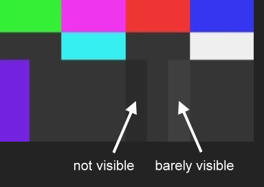

In the bottom left corner is the black level section. There are two vertical bars within the black area. The one on the left should be the same shade of black as the rest of the bar. The one on the right should just barely be visible. Here's that section of the chart brightened up to make the bars obvious:
Unfortunately that chart doesn't have a white level section.
