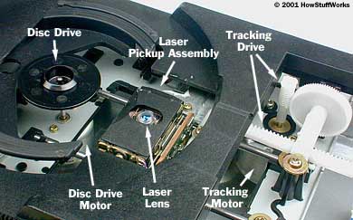

    I'd agree that a through cleaning would be worth a try, even if you have to partially dissasemble it to get at the laser lens and the guides. If you haven't seen those, they look something like this CD player:
    You might also check the slides that the laser assembly slides on and carefully lubricate them if needed. If nothing else you will learn more about the internals of a DVD player.
