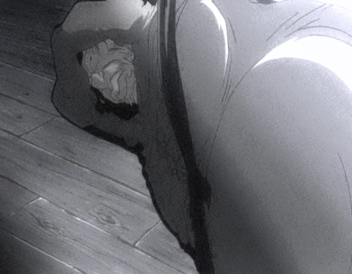

    Before (huge levels adjustment to bring out all the details):

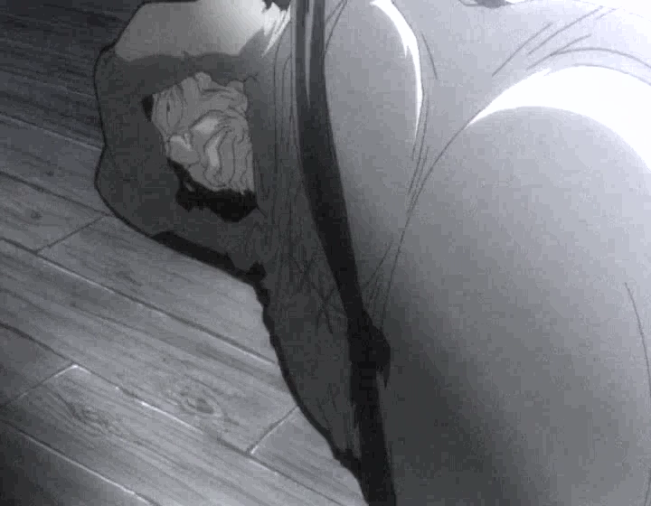

    After GradFun2DBmod():
    But I think you're going to find that once you recompress the video most of that banding will come back unless you use a really high bitrate.
