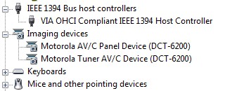

This only happens when I connect a cable tuner box (MPeg2_TS).Recommends: Kiva.org - Loans that change lives.
http://www.kiva.org/about -
This is what it looks like. The AV/C tuner has no affect on DV capture.
