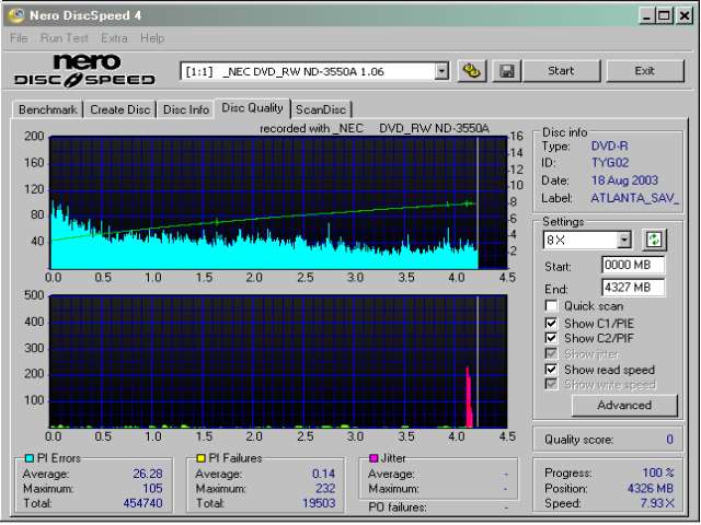

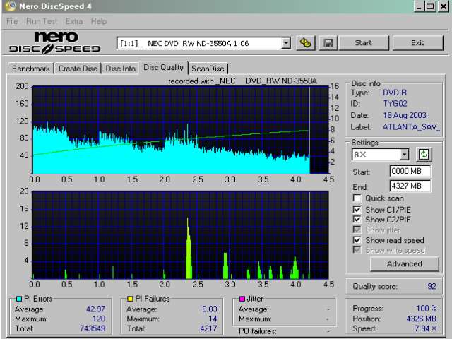

    Have some results for your guys to look at and tell me what is going on. Both copies of the DVD play. Nero 6.jpg used Nero 6 'Copy Entire Disc' and made an .nrg file to the HD. Then burned in NEC 3550 at 4x using TY02 8x DVD. Imgburn 1.jpg used ImgBurn to create an iso on the HD and burn a TY02 at 4x.
    Don't like the looks of the red spike at around 4.2gb with ImgBurn but doesn't affect playing.
    Feb 2003
    Here is imgburn jpg

    Here is Nero 6 jpg
  15. As was mentioned NEC writers aren't good for reading errors, get yourself a LITE-ON to test with KProbe.
    I was once obsessed with errors but I realized that as long as the disc plays that's all that matters, if you want to go down that path then I suggest hanging out at http://club.myce.com
