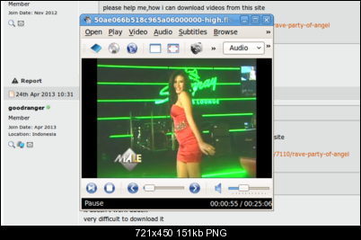

  7. Originally Posted by goodranger View Post
    please help me,how i can download videos from this site
    example like this video:
    http://us.mytrans.com/video/2012/11/22/62/63/116/7110/rave-party-of-angel
    thanks,anyone please
    use TubeDigger

  9. Member bat999's Avatar
    Feb 2008
    very difficult to download it
    RTMPDump will download it.
    rtmpdump -r "rtmp://stream.sg.mytrans.com/vods3" -a "vods3" -f "LNX 10,1,102,64" -W "http://us.mytrans.com/js/player2.swf" -p "http://us.mytrans.com/video/2012/11/22/62/63/116/7110/rave-party-of-angel" -y "mp4:amazons3/mytrans/50ae066b518c965a06000000-high.m4v" -o 50ae066b518c965a06000000-high.flv
    [Attachment 17559 - Click to enlarge]
    how large the video size bro?
    i don't completed downloading,stuck at 19.10% (195768.378 kB),can i resuming this?
  11. Member bat999's Avatar
    Feb 2008
    It is 102.3 MB.
    Add --live to your command.
    rtmpdump -r "rtmp://stream.sg.mytrans.com/vods3" -a "vods3" -f "LNX 10,1,102,64" -W "http://us.mytrans.com/js/player2.swf" -p "http://us.mytrans.com/video/2012/11/22/62/63/116/7110/rave-party-of-angel" -y "mp4:amazons3/mytrans/50ae066b518c965a06000000-high.m4v" -o 50ae066b518c965a06000000-high.flv --live
    @ubuntu:~$ rtmpdump -r "rtmp://stream.sg.mytrans.com/vods3" -a "vods3" -f "LNX 10,1,102,64" -W "http://us.mytrans.com/js/player2.swf" -p "http://us.mytrans.com/video/2012/11/22/62/63/116/7110/rave-party-of-angel" -y "mp4:amazons3/mytrans/50ae066b518c965a06000000-high.m4v" -o 50ae066b518c965a06000000-high.flv --live

    99909.178 kB / 1506.28 sec (99.9%)
    Download complete
