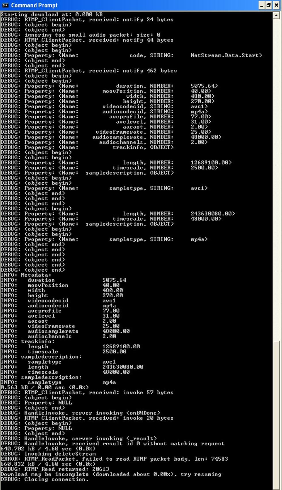

    Thank you so much for looking into that for me - I didn't have any luck though, rtmpdump v2.3 fired up with that command and downloaded about 600B for 4sec and then gave me an "ERROR: RTMP_ReadPacket, failed to read RTMP packet body. len: 74583"

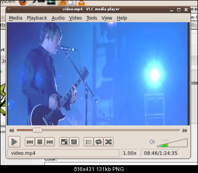

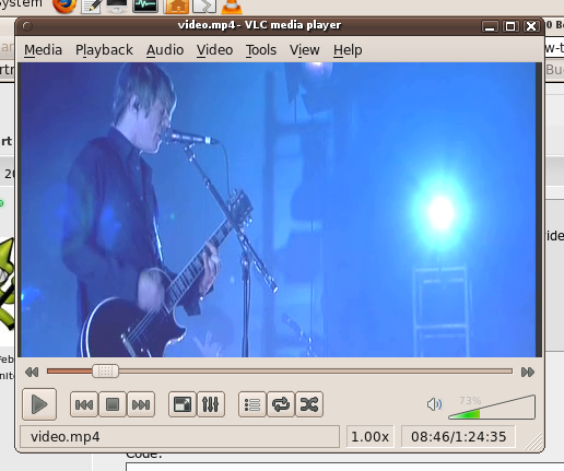

  4. Member bat999's Avatar
    Feb 2008
    [QUOTE=ridley;2055419]
    Try again maybe.
    Complete name                    : video.mp4
    Format                           : Flash Video
    File size                        : 723 MiB
    Duration                         : 1h 24mn
    Overall bit rate                 : 1 194 Kbps
    Video
    Format                           : AVC
    Format/Info                      : Advanced Video Codec
    Format profile                   : Main@L3.1
    Format settings, CABAC           : Yes
    Format settings, ReFrames        : 2 frames
    Format settings, GOP             : M=2, N=16
    Codec ID                         : 7
    Duration                         : 1h 24mn
    Bit rate mode                    : Variable
    Maximum bit rate                 : 14.0 Mbps
    Width                            : 480 pixels
    Height                           : 270 pixels
    Display aspect ratio             : 16:9
    Frame rate mode                  : Constant
    Frame rate                       : 25.000 fps
    Standard                         : PAL
    Color space                      : YUV
    Chroma subsampling               : 4:2:0
    Bit depth                        : 8 bits
    Scan type                        : Progressive
    Color primaries                  : BT.601-6 525, BT.1358 525, BT.1700 NTSC, SMPTE 170M
    Transfer characteristics         : BT.601-6 525, BT.601-6 625, BT.1358 525, BT.1358 625, BT.1700 NTSC, SMPTE 170M
    Matrix coefficients              : BT.601-6 525, BT.1358 525, BT.1700 NTSC, SMPTE 170M
    Audio
    Format                           : AAC
    Format/Info                      : Advanced Audio Codec
    Format profile                   : LC
    Codec ID                         : 10
    Duration                         : 1h 24mn
    Channel(s)                       : 2 channels
    Channel positions                : Front: L R
    Sampling rate                    : 48.0 KHz
    Compression mode                 : Lossy

  6. Thanks for that guys but I've tried it a hundred times now and it still doesn't work. I'm using a university's highspeed broadband connection so I don't think the signal is the problem, so I give up!!!
    If any kind soul could rip it and megupload it for me I would be forever grateful!

  9. Good to hear everyone else is having no problems, thanks again to bat999 for giving us the URL (that really is the hardest part).
    I have been doing this correctly (exactly as vhelp detailed) but my computer just doesn't want to get past 600kB for some reason.
    If anyone has been able to download this video could PLEASE megaupload it for me (I know it's 700mb+ so would be very thankful), I can point you in the direction of plenty more high quality videos from his awesome band
    Cheers and thanks again!
  10. Originally Posted by ridley View Post
    Are you sure your university isn't blocking the transfer?
    You could be onto something there, I'll try it again on my home laptop later...

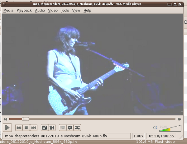

    Hi
    RTMPDump works with moshcam.com too.
    For example:-
    The Pretenders
    Enmore Theatre, Sydney
    8th December 2010
    http://www.moshcam.com/the-pretenders/enmore-theatre-849.aspx#/1-boots-of-chinese-plas...hinese-plastic
    This is the command:-
    rtmpdump -r "rtmpe://streaming.moshcam.com" -a "" -f "LNX 10,1,102,65" -W "http://www.moshcam.com/chooktv/Core/Flash/Container.swf" -p "http://www.moshcam.com/the-pretenders/enmore-theatre-849.aspx#/1-boots-of-chinese-plastic" -y "mp4:thepretenders_08122010_e_Moshcam_896k_480p.mp4" -o mp4_thepretenders_08122010_e_Moshcam_896k_480p.flv
    Chrissie Hynde's still hot.
