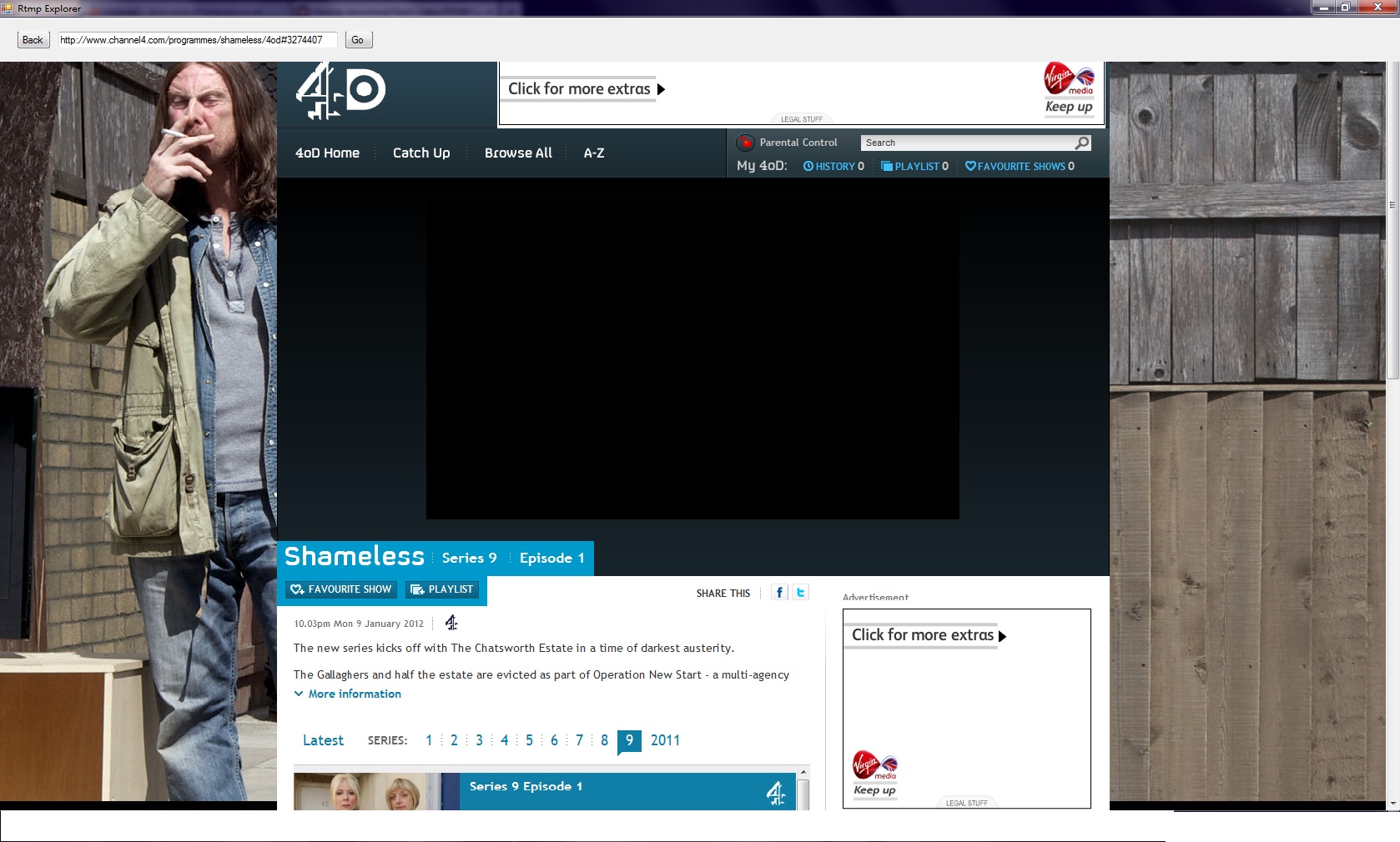

  9. Hello Batman i have used most programs with no luck it seems urlsnooper is able to find the rtmpe stream but finding hard download via rtmpdump here is the stream rtmpe://ak.securestream.channel4.com/4oD/mp4:assets/CH4_08_02_900_51435001001002_001.mp4
  10. Stream recording expert Bahman's Avatar
    Dec 2011
    Tehran, Iran
    Download this package and extract it into one folder, then open rtmpexplorer.exe, will be opened 2 windows(rtmpexplorer+rtmpsrv)!! Put the webpage link in rtmpexplorer and wait till video starts playing, then you will see rtmpsrv detects the stream url and tries to download that!!
    Note: For opening rtmpexplorer, you need .Net Framework 4!!
    BTW, my name is Bahman!!
  11. thank you for a fast reply sorry i got your screen name wrong lol i have downloaded the package run the program and went to the website but now the video will not load in the browser
Name:	no loading.jpg
  12. Stream recording expert Bahman's Avatar
    Dec 2011
    Tehran, Iran
    first, Use CCleaner!! then again open rtmpexplorer!!
  13. the video is now playing but the program is sitting idle
