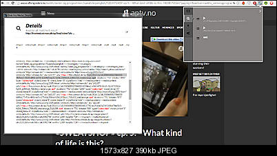

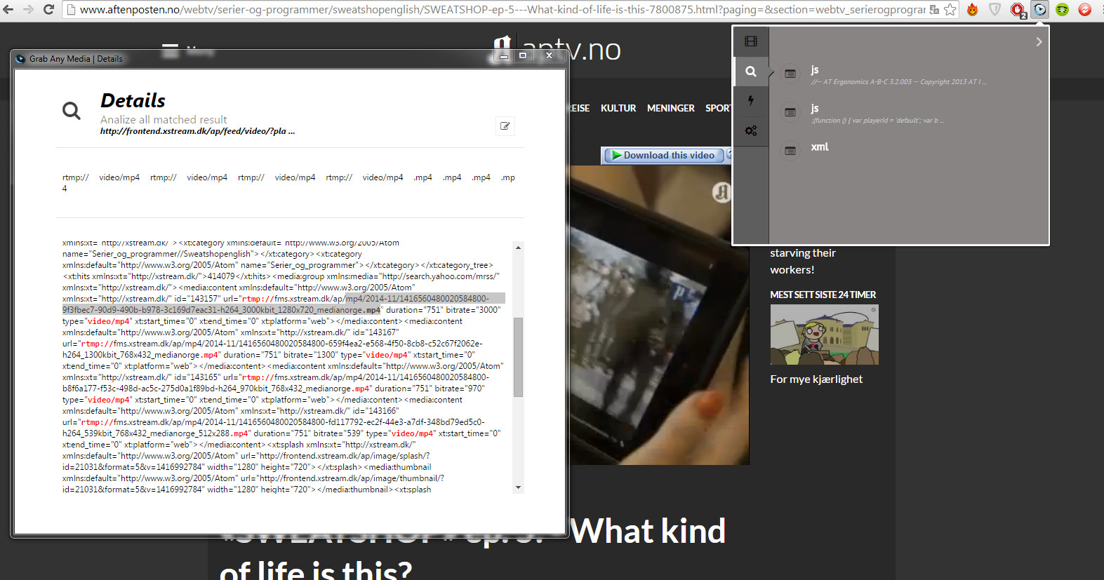

    use grab any media to find the 720p playpath
Name:	bandicam 2015-02-14 20-08-30-549.jpg
