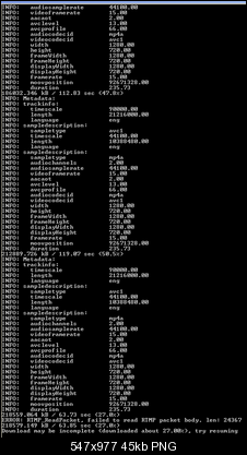

  20. Hi, Has anybody on here had any success in downloading the stream for any of the vids on Digital Tutors?
    I tired a while back but being an artist and not having a strong technical background I failed as the method was a pain and involved code.
    Any help/guidance would be very much appreciated!

    Try rtmpexplorer!! after it detects url, close all windows, open created command.bat (by rtmpexplorer) and remove "--live", double click on command.bat, and you will see:
    rtmpdump -r "rtmpe://cp86046.edgefcs.net:1935/ondemand" -a "ondemand?auth=daEasczbUd6bsbvaKdmcYc.cMbPcBbTcvbW-bpozeJ-4q-apGD4DFpzvo&aifp=v006&slist=bisonvp/bison_courses/640/640-1-h" -f "WIN 11,2,202,197" -W "http://assets2.digitaltutors.com/vp/embedded/Frankenstein_102511.swf" -p "http://www.digitaltutors.com/11/training.php?vid=13192&autoplay=1" -y "bisonvp/bison_courses/640/640-1-h?auth=daEasczbUd6bsbvaKdmcYc.cMbPcBbTcvbW-bpozeJ-4q-apGD4DFpzvo&aifp=v006&slist=bisonvp/bison_courses/640/640-1-h" -o 640-1-h.flv
    RTMPDump v2.4 GIT-2011-12-22
    (c) 2010 Andrej Stepanchuk, Howard Chu, The Flvstreamer Team; license: GPL
    Connecting ...
    WARNING: HandShake: Type mismatch: client sent 6, server answered 9
    INFO: Connected...
    Starting download at: 0.000 kB
    INFO: Metadata:
    INFO:   duration              101.00
    INFO:   width                 1280.00
    INFO:   height                720.00
    INFO:   videodatarate         1000.00
    INFO:   canSeekToEnd          TRUE
    INFO:   videocodecid          4.00
    INFO:   audiodatarate         96.00
    INFO:   audiocodecid          2.00
    INFO:   framerate             15.00
    INFO:   creationdate          Fri Jan 13 17:45:09 2012
    INFO:   Encoded_By            Digital-Tutors - All rights reserved
    INFO:   Encoded_With          Sorenson Squeeze
    444.411 kB / 5.07 sec (5.0%)
    Good luck!!

  24. I was downloading this:
    rtmpdump -r "rtmpe://fun.now.mn:1935/vod" -a "vod/" -W "http://fun.now.mn/flowplayer/flowplayer.securestreaming-3.2.3.swf" -T "#ed%%h0#w@1" -y "mp4:clip/Ansu_Gantulga_-_Zahidal.hd.mp4" -o "Ansu Gantulga - Zahidal HD.flv"
    It was interrupted in the middle. How to resume from the last part, not from the beggining?
    One question:
    The output infos below showed many segments. May you, please, explain such separated parts?
    Thank you.
  25. Stream recording expert Bahman's Avatar
    Dec 2011
    Tehran, Iran
    ^Add this before -o parameter:
    -e "Ansu Gantulga - Zahidal HD.flv"
    Anyway, It seems the server response is strange!! Your downloading video will be crashed! Try to use -v parameter!!

  27. Stream recording expert Bahman's Avatar
    Dec 2011
    Tehran, Iran
    As I said, your downloaded video is crashed!! Take a look on that pic you attached, rtmpdump has downloaded 50% of file but after that it returns to 27% and keep on downloading!! This video file is corrupted!! You can't resume it!!
    That's problem of server or rtmpdump!! You have a way only: put -v or --live parameter every where you want!!
