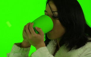

i'm trying to remove green chrome using Adobe PPro CS4
the main charcter holding green cup & i want to remove the cup.
when i did this it's removes some part of charcters body ?
how can i remove green chrome with in the scene without lossing any part of the charcter ?
Regards
Fary
You have lots of color spill - light from the green background is reflected onto the character. A green color key will remove shades of green, and you can see lots on the character's sleeves and fur.
It will be tough to get a good color key using just premiere's plugins. You can try some plugins from after effects; keylight has a spill surpressor, and there are some 3rd party plugins as well like key correct pro, a few others but I doubt you will get satisfactory results . -
You might try creating a mask around the cup instead of trying to key it out.
What do you intend to replace the cup with? -
If you have access to After Effects and Keylight, that is a fairly easy key to do just by using a few junk masks and some colour replacement (for your sleeves)
If your unable to do this a solid tip would be to use multiple individual keys with small amounts of colour varience, and selecting a key for a light green, another for a darker green etc, rather than trying to use one key to pull it all by increasing the varience, as it will catch other things as well.
