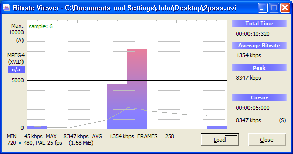

Find a video with lots of static scenes and a very busy scene and encode with variable bitrate.
2pass.avi
Bitrate Viewer graph (one second intervals):

My sample video? Using what software? What settings? You really need to be clearer about what you are doing. Nobody here can read your mind. But, in general, don't expect an encoder to hit your average bitrate when encoding a very short, highly unusual, video like the one I posted. Also, don't expect tools to report statistics about such files properly either. And lastly, don't expect a second generation encoding using an AVC encoder, encoding an Xvid AVI file, to work really well.
