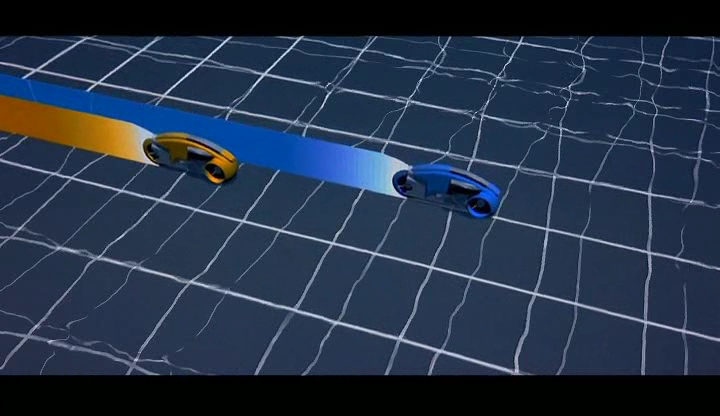

  12. When an encoder has a quality settings (typically 0 to 100) for two (or more) pass encoding, it usually controls how wide a search is made for motion vectors. The wider it searches the more likely it is to find motion motion vectors and the better the compression will be. But very wide searches require lots more time to complete. And for most videos going above a medium settings makes very little difference in the final output. You'll have to experiment with the setting in Nero to see if it really makes any difference in your final output.
    If Nero's Motion Adaptive Frame Rate Conversion really is synthesizing in-between frames with motion interpolation you need to watch out. Those algorithms work for some types of material but not for others. See the "bad60.avi" sample in the following post:
    https://forum.videohelp.com/threads/307004-Best-framerate-conversion-%28eg-23-97-to-30-...=1#post1888926
    All those grid lines should have been perfectly straight.
