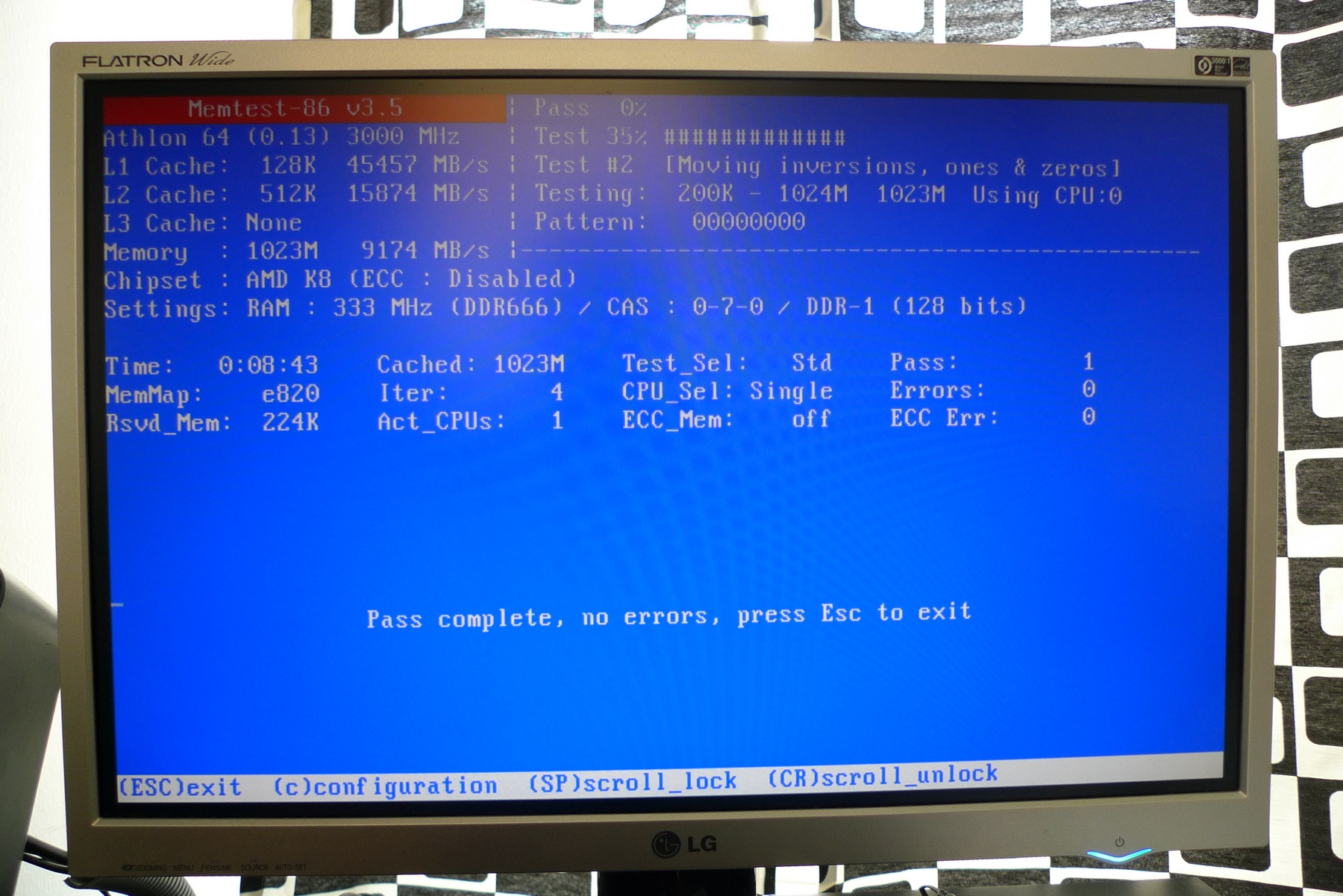

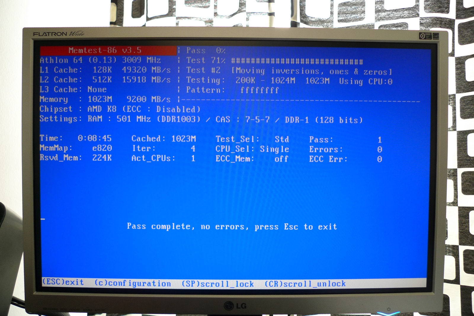

    I took also Memtest and the results are:
  19. In my experience, memory tests are almost completely useless. The failures tend to be of a random and intermittent nature. Sure, a test can identify a bad chip, but often the test shows nothing when the chip is, in fact, bad. Removal and/or Replacement testing can pinpoint a problem in a few minutes.

    Taking a PC which has failed to boot four times in a row, removing ONE and ONLY ONE piece of hardware, with no other changes, and getting successful boots, now THAT is a good diagnostic test. EXTREMELY IMPORTANT to follow it up by putting the PC back in the original condition, or with ONLY the suspect RAM stick in, getting the problem again, then swapping the good stick back, and solving the issue, AGAIN, this NAILS the bad RAM stick. Eliminate the bad RAM, Eliminate that particular problem.
    Note that you may need to duplicate the on-all-night pre-condition for the test, often getting good and warm is necessary to reveal a failure.
    Describe the results of this test, and if not performed, explain in detail your reasoning for not doing so.
    Once this is done, then any other existing problems can be addressed. It is a process of elimination. If done with clear logic and not guesswork, with appropriate double-checking, this process ALWAYS repeat ALWAYS will arrive at the solution.
