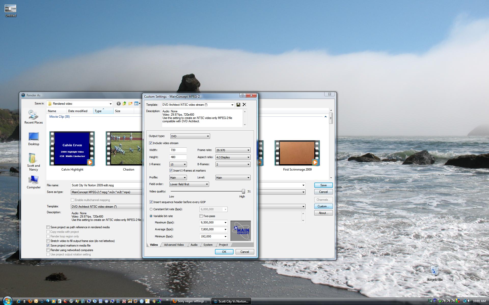

I have really noticed that the last dvd that I made did not look that good. I was wondering if anyone could help me with my settings.
Here are the properties that I have. What should I change?

I would checkmark 2pass in the render settings, instead of 1pass vbr -
Set it to "two pass" and a minimum bitrate of 2,000,000 bps, also set maximum to 9,000,000 bps to be safe. Make sure you have the right aspect ratio, if the source is 16:9 then output 16:9.

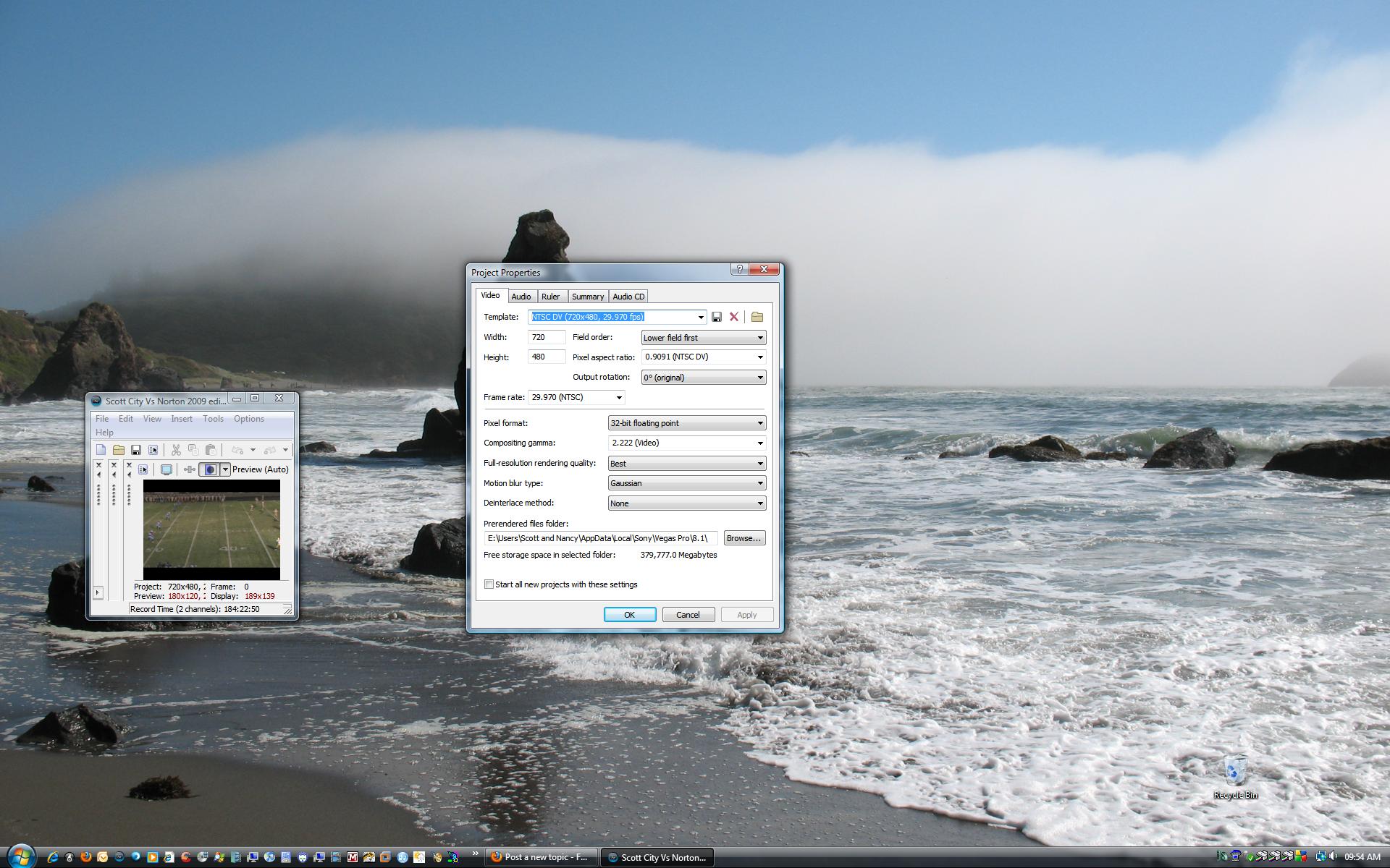

What about the project properties that I have listed in my first post? Any advice there?

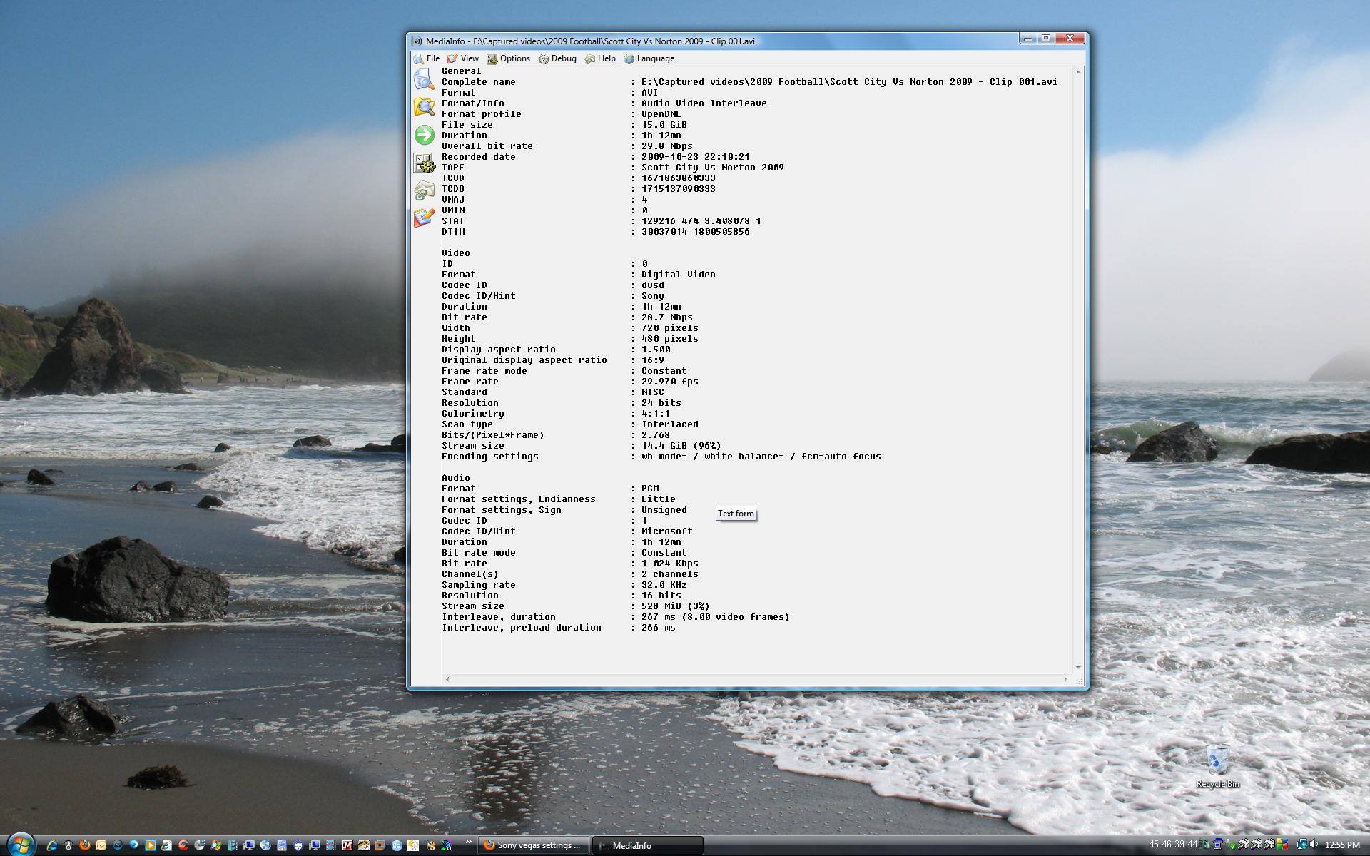

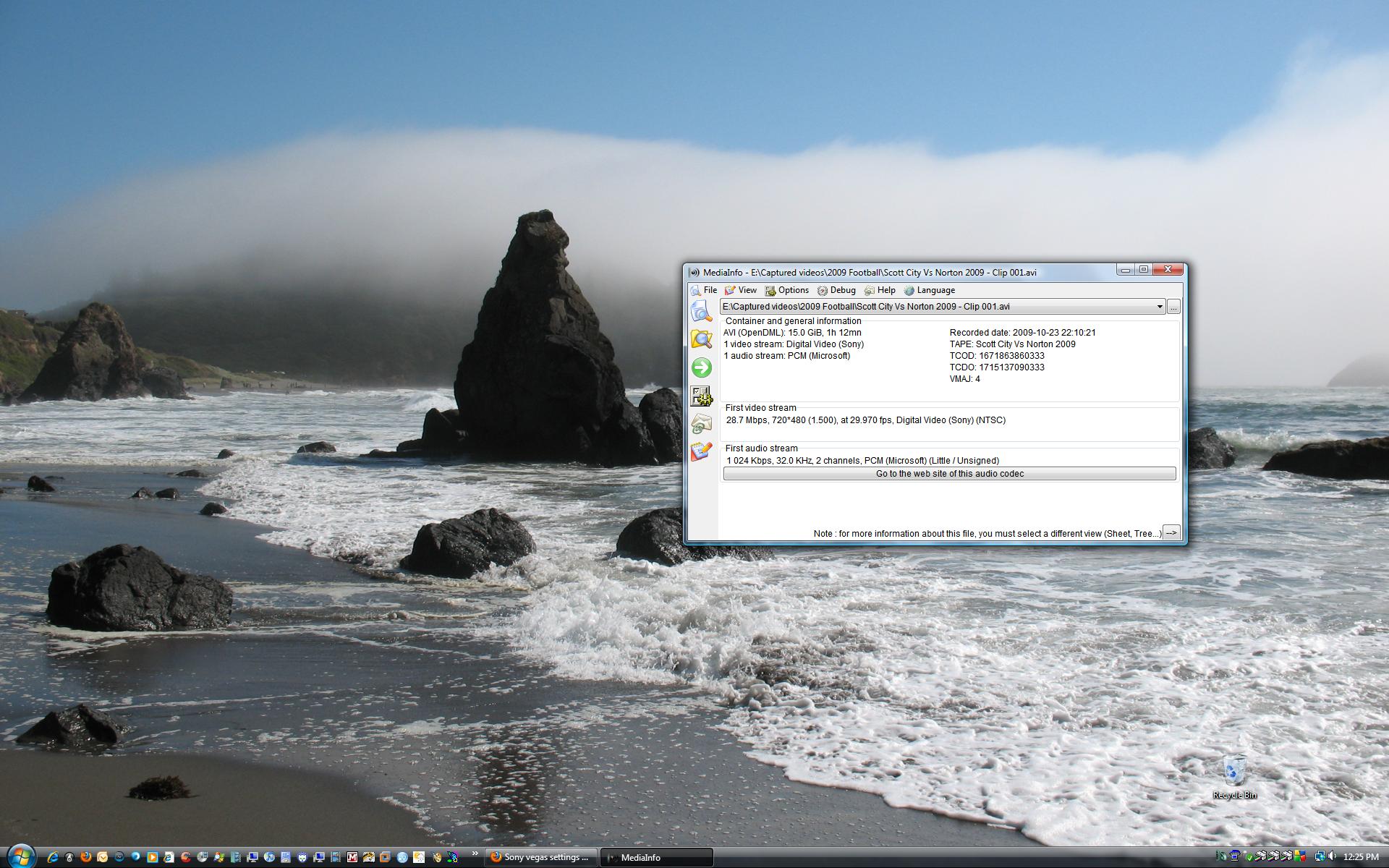

Here is what mediainfo shows. Can you help me with that?

Ok, here is the text
This is my original video.

what i was tying to say before was that i think miniDV cam should shoot in 4:3 not 16/9. there tends to be a bit of blurriness when the 720X480 is stretched out to 854x480 on playback.
i don't see any thing else out of order in your settings the others haven't already mentioned.
you did right click on all the DVavi source files in vegas and make sure they are identified as widescreen DVavi 16/9? lower field first? -

Your settings look OK. You can increase average bit rate for better compression quality.Recommends: Kiva.org - Loans that change lives.

with videos that length you might as well use cbr 8000. no need for vbr.
What will that give me compared to vbr? Thanks again for your time and responses.
cbr will encode much faster, and at the same high quality throughout the video. vbr is useful for encoding video that needs to allocate bits sparingly where it can, to reduce the file size. you don't need to.
