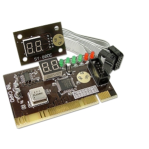

I use a motherboard code reader (Soyo Brand) that reads the POST codes during boot. The last machine that I tested would almost get to the windows splash, and then shut off. It looked like a bad MOBO or faulty HDD on the surface - the code reader diagnosed it as a bad processor. Once I replaced the processor: The machine worked.

What is that code reader called exactly or a link ?
I did a search and could not find anything.
EDIT:
Okay i changed the wording and found some small one's with a LED number display.
But i'm still interested in which one you use. -

Soyo TechAid PCI Diagnostic Card - Decode POST!
Here's a link to what it is:
http://www.geeks.com/details.asp?invtid=SY-TECHAID&cpc=SCH
Neat little card, insert into the PCI slot, boot and read. BTW: You might want to video it if there's alot of codes.
minidv2dvd is correct: You can't find them anymore.
I did locate a refurb for $49:
http://www.discountelectronics.com/index.php?l=product_detail&p=212
