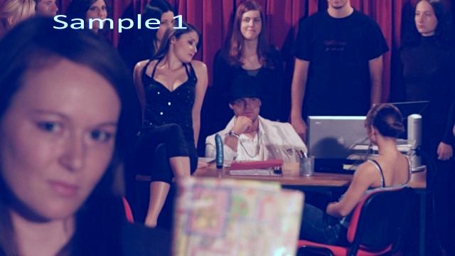

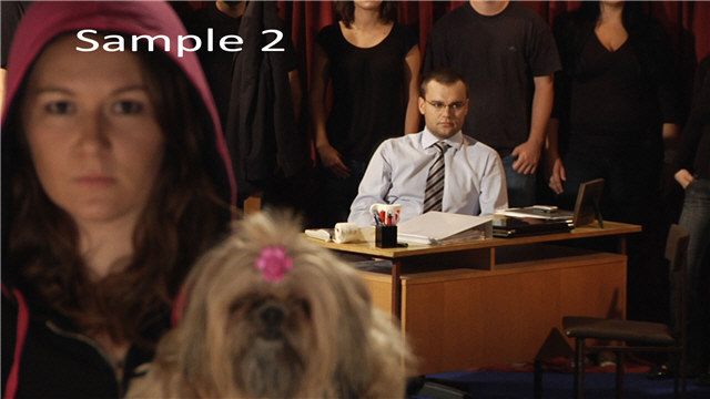

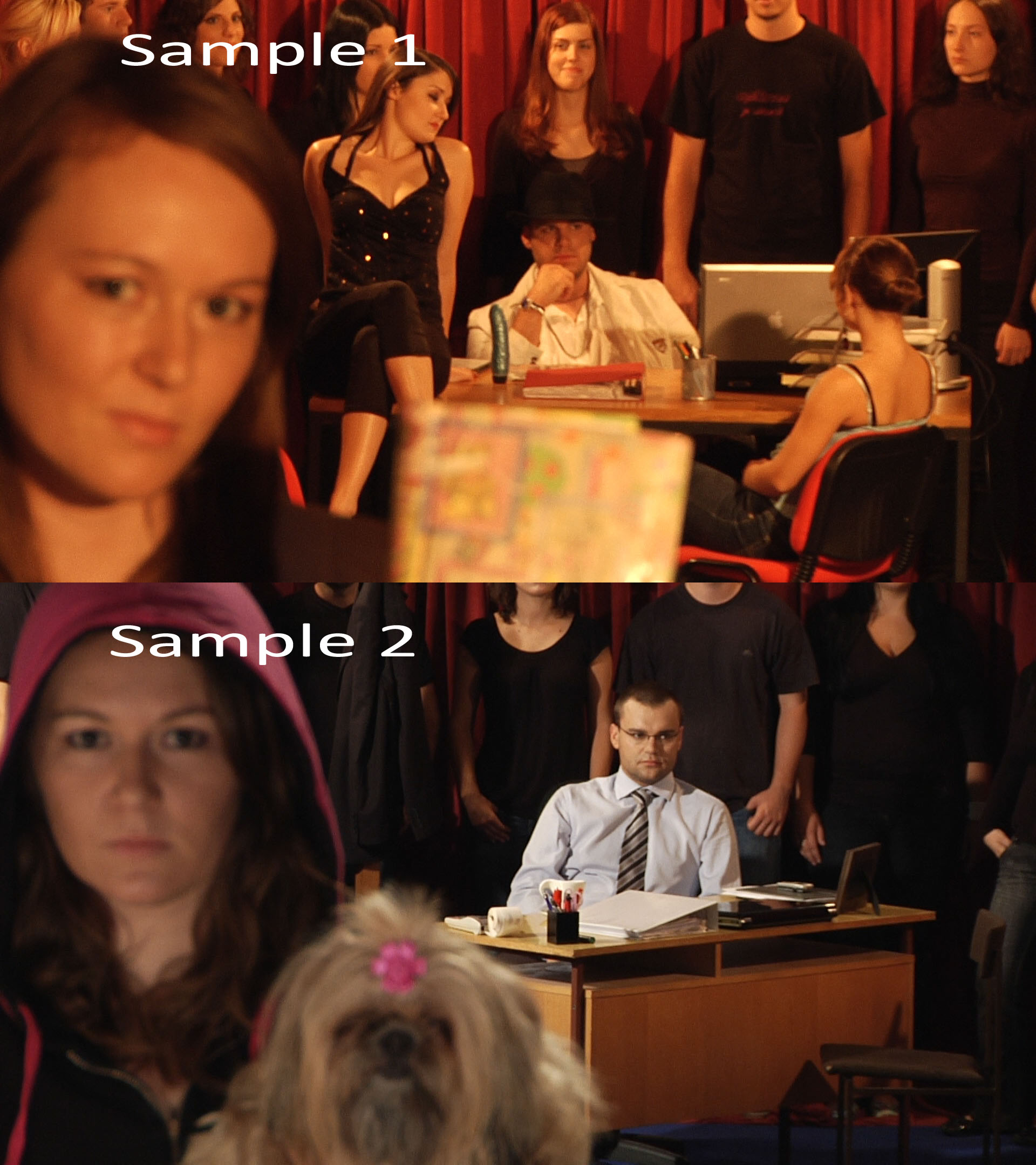

    I have a problem with white-balance. I've made a mistake at shooting, because I didn't manually set white balance.
    I am wondering if there is an easy way - to somehow analyse one clip/frame and then the other, and then just set some parameters. Is it possible to do it in A. Premier or AE?
    I'm attaching an image of two frames - Sample 1 is the one with wrong white balance..., sample 2 is the one with right. Is it possible to somehow tell that to an editing program?

    Im usinh HD... 1080p (24p)... does this chanes your answer?
  4. Yes you can color correct in programs such as AE, Premiere, Vegas. There are color match filters , but you usually need to manually fine tune adjustments for shadows/midtones/highlights and levels adjustments in each of the red/blue/green channels. So it's not as easy as push a button and presto it works...it takes a bit of fiddling

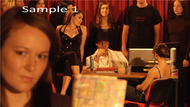

    I adjusted levels in red, green blue in after effects here. There's lots of room for improvement (eg. the blacks and shadows don't quite match between the corrected #1 and #2), but I just wanted to quickly demonstrate it's possible to improve on the color cast.
    Color adjustments should be done before things like titles and other effects (notice the overlay letters have a blue discoloration now), unless you mask them out or apply corrections to masks

    Ok - I see, you're really good at it... I'm trynig my best on it for almost two days now, and I did't come even close to your "quick" solution ... could you help me some more...please !
  6. No, I'm not very good at it. I'm still learning stuff too. You can definitely improve it if you spend more time
    I just played with the levels filter, and the key here is to adjust individual R,G,B channels in the levels filter. Many people forget that you can do that with the levels filter, and use "RGB" mode for the levels filter only. You could use "levels (individual channels) filter", but it's the same thing.
    The general approach is to start with the red channel (because that's the worst in your example). Then I just played with the gamma and output sliders, and did that for each channel
