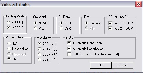

First thing you should do is play them on your PC, if they look good then the problem is your player/TV. If you are positive that your DVD's are anamorphic(16:9) then the IFO files weren't properly tagged when you authored them.
1.Drag the VIDEO_TS folder to your desktop,etc.
2.Use MediaInfo (use tree view) to make sure the VOB files are 16:9.
3.If they are 16:9 then in IFOEdit open each file and make sure they look like this:
4.Make sure to save any changes.
5.Burn a new DVD with ImgBurn,etc.
If they're letterboxed 4:3 then do what fritzi93 recommended. -
