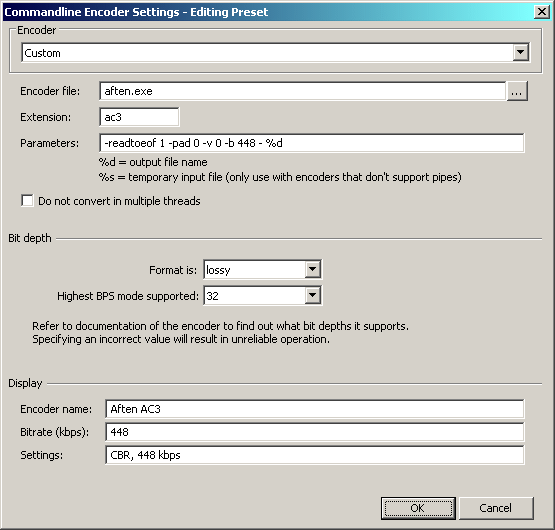

    These days, if you create a folder called "encoders" and put it in the folder where foobar2000 resides, foobar2000 will check it automatically, so if you created a custom encoder preset for Aften, you'd only need to tell foobar2000 the encoder is aften.exe. If the encoder you're using is in another location, then you have to specify the full path.

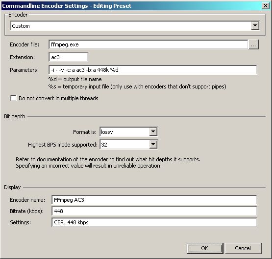

    Aften is no longer the recommended AC3 encoder. You can still use it, but it was merged back into ffmpeg a while ago and abandoned. It's possibly better to use ffmpeg for AC3 encoding instead. This is what one of my foobar2000 custom encoder configurations for AC3 encoding with ffmpeg looks like. ffmpeg.exe is in the "encoders" folder so there was no need to specify the full path.
    Command line: -i - -y -c:a ac3 -b:a 448k %d

    Or an old Aften preset.
