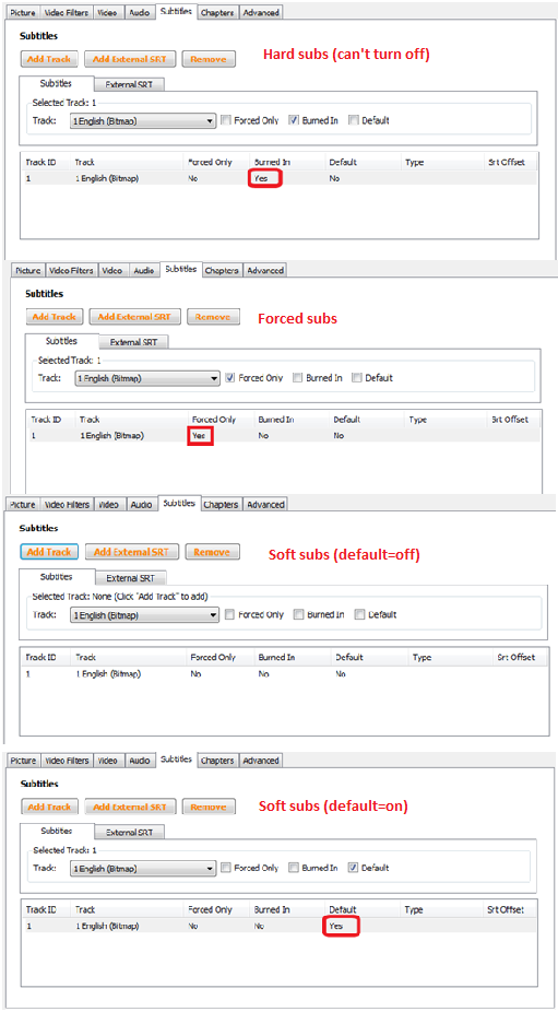

Woah there, yes it is true that Handbrake 0.9.3 (stable version) can only take soft subtitles if you mux them in later. However, the svn2845 found here (don't go to the link that the forum puts in for Handbrake, go to that link) can handle soft subs. Here's a screen shot:Originally Posted by rapaz
Hi minerva.thegift, I tried the 'burned in' option that you highlighted however that produced hard-subtitles i.e. you can not turn them on and off. I'm looking for soft-subs. But I must say, thanks for making me stick with it coz I was just about to quit and then tried 'default' subs and it worked!!!
[edit] after more testing I realised that 'default' is obviously used to set your default subs if you are using several. I assume then, to have soft-subs you simply have to ensure that you don't tick 'forced only' or 'burned in'. Testing this now...[/edit]
Summary of subtitle options:
'forced only' is for subs to be burned in only in places where a foreign language is spoken (e.g. the movie Babel would be perfect for 'forced only' unless you understand all the languages in the film).
'burned in' is for hard-subs i.e. you will not be able to turn them off
'default' to choose your default subs, only useful if adding several subs
This version of Handbrake svn2845 appears to be great. The program is very quick too!!! I found the other programs that I tried took much longer.

Oh, sorry about that! I put a red box around the "Burned In" checkbox to show that it is unchecked - you're right, checking it gives you "hard" subtitles. I'm glad Handbrake is finally working for you

- After much testing I found that, for me, the best answer is Handbrake svn2845 (link). This particular version is, to my understanding, still in the test phase however you must use this version to get soft subs into your container.
-nb: my experience with this has been on Windows 7 RC (32bit). I also noticed that all cores on my Intel Core i7 860 were being used throughout the process.
Overview of subtitle options (see image for reference):
1) Hard subtitles - you can't turn the subtitles off!! (e.g. English speaker wants English subs on Chinese MA film)
2) Forced subtitles - subs only appear when language other than main audio lang is spoken (e.g. A movie like Babel where most of the film is spoken in English but you probably want English subs when people speak languages other than English during the film)
3) Soft subtitles (default off) - you have the ability to turn them on/off. In this particular case the default is off. This is the one I was looking for!
4) Soft subtitles (default on) - same as above but default is on
Note: You might want a couple of subtitle tracks e.g. English movie subs and English director comments. You could have both of them off as per #3 above or you might want as per #4 where the English movie subs are default on but you have the option to choose the director subs or turn subs totally off.

I'm still kind of confused. So are you saying that you DO NOT need any other program except handbrake to do this. If I want to be able to encode a file with optional subtitles, then all I have to do is select DEFAULT? Is that it? It seems a little too easy for all this trouble. I am having the same issue except I am trying to re encode an mkv to an mkv. I have encode this same file 3 times with no luck. The video is fine and the audio is fine, but there is no subtitle option. The original file has the option, but not the re encoded one. Let me know if the solution is just as simple as checking off the DEFAULT option. Thank you.
Hi kinghlg. If you want the option of being able to turn subs on/off then you should follow my guide for 'soft-subs'. You will notice in the guide that there are two soft-subs option, the difference being whether the subs will appear 'on' by default or 'off' by default with the option of being able to turn subs off or on respectively. Make sure that 'forced only' and 'burned in' are checked as 'NO'.
One other point to note is that I am using Handbrake version svn2907 (2009103101). Unfortunately the link I provided in the guide doesn't point to this particular version anymore. So you will have to go in the forums to ask which you require. Maybe the normal version on the Downloads pages is now the same as by pre-stable version mentioned above.
Also, I don't quite understand what you are trying to do. It sounds like your orig file is just as you want it. Are you just wanting to cut the file size down? I'm not really that clued-up on all this stuff. My guide is just from my experience trying to do this one particular thing. Also note that I was doing all this from Video_TS files, which I had ripped from my own DVD collection.
Hope this helps... -
